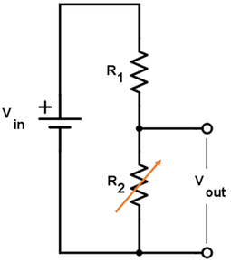

Velostat is a piezoresistive material that decreases in resistance as pressure is applied. We will create a voltage divider with the Arduino to measure pressure applied to the Velostat. R1 is our 100 olm resistor and R2 is our Velostat pressure sensor. Assemble the voltage divider using your Arduino, breadboard, jumper wires, and alligator clips. Wire the LED to the digital pin. (Click on the Arduino schematic above to see what pins to connect.) In the next step, we will run MATLAB code to record and plot Vout and to turn on the light if a certain amount of pressure is detected.

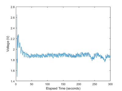

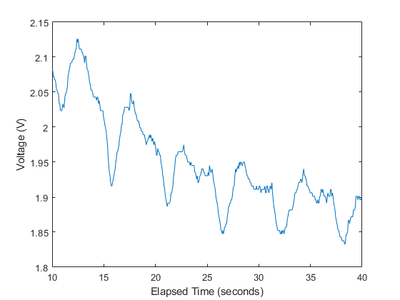

The MATLAB code uses the MATLAB Support Package for Arduino Hardware and is available on GitHub at gwusk/wearable-bioinstrumentation. Once you have installed the support package and downloaded the pressureSensor function, connect your Arduino to your computer and call the function.
Congratulations! You can now record and plot voltage data from your pressure sensor. You can also adjust the threshold to control the LED. Try lying on the sensor to measure respiration. Adjust the threshold so that the LED turns on when you are situated on the sensor. I would recommend placing the sensor on a bed and covering it with a blanket for comfort. Remain still and breathe. Can you see your inhales and exhales in your data, like you can in the 5-minute and 30-second samples provided?
