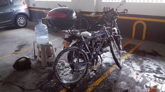

Step 11: Hell Yeah!
The 20 litre jug is enough for washing a medium sized motorcycle. Mine is a small one, so why don't wash the bicycle too?
You will know that the water level is going low when the sound of the pressure washer motor changes. Don't allow the bottle to go empty, to avoid overheating the unit.
