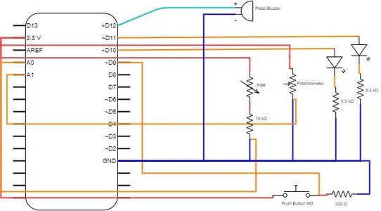

Step 1: Place the LEDs
To get started, connect the power bus to the 3.3V pin and the ground bus to the GND pin on the Arduino.
Place your LEDs in succession with each other over the gap in the breadboard, keeping the anode and cathode ends on either the left or right side of the gap. Connect the anode ends of the LEDs to any digital pin on the Arduino - I used pins 11 and 10 for my two LEDs.
Place a 220k - 3.3k ohm on each of the cathode ends of the LEDs, then connect the other end of the resistors to ground.

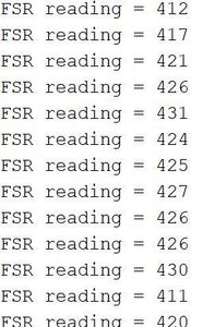

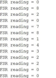

Step 2: Place the Force-Sensitive Resistor
Courtesy of this source for the information and schematic placement.
Place the force-sensitive resistor on the board facing upwards so that it is secured. Connect the 3.3V power source to one end of the FSR, then connect one end of the 10K ohm resistor to the other end of the FSR. Leave room next to this latter end of the resistor and connect it to an analog input pin on the Arduino - I used pin 0. Finally connect the other end of the resistor to ground.
In the loop of the code, read in the FSR using analogRead() and print this reading to the Serial output. If the FSR is connected correctly, you should be able to see outputs near 0 for its neutral state. If you apply pressure to the FSR by squeezing it slightly, the reading should jump to values above 100.

Step 3: Place Piezo Buzzer
Schematic placement courtesy of this source.
Place the piezo buzzer with one end connected to a digital output pin on the Arduino - I used pin 12 - and the other end connected to ground. Ensure that no other parts are connected along the same rungs as the buzzer.

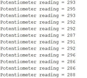

Step 4: Place Potentiometer
Place the potentiometer on the board, ensuring that nothing else is connected to the same rungs. Connect the middle end of the potentiometer to an analog input pin on the Arduino - I used pin 1. Then connect one of the outer ends of the potentiometer to 3.3V power, and the other end to ground.
In the code, set the potentiometer as an input, then use analogRead() to read in the values. Print the readings to the Serial output. If the potentiometer is connected correctly, the values outputted should range between 0 - 1023 and change when turning the dial.
Step 5: Completed Circuit
Step 6: Using the Force-Sensitive Resistor to Play Melody
The FSR can be used to start playing the melody as well as vary the duration of each note in the melody.
In the code, first add a condition that if the FSR reading is above 100, play the melody. This will allow the melody to be played only when you administer pressure to the FSR.
Then modify the playMelody() function to take in the FSR reading as a parameter, which can be used to determine the duration of each note: a softer pressure will play the melody slower, while a harder pressure plays it faster.
Normalize the FSR reading to be a decimal number between 1-10 by dividing it by 100, then use this normalized FSR reading as a multiplier for each of the individual note durations.
