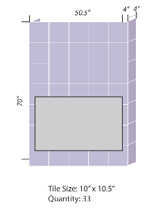

Step 3: Measure and Mark
Measure the space including the TV cutout, and mark the locations with a pencil on the wall. The front panels of foam core should over hang the sides by 1/8". This means that you need to mark 1/8" inwards from your desired final edge location.
This is done so that the corners where the front and side meet will look even with no gaps when you are done.

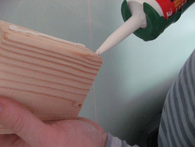

Step 5: Glue 2x4 Blocks to Wall
Using a laser level and Loctite, glue the blocks down with the outside edge of the block matching your pre-marked edge. Make sure to keep the blocks close together enough so the foam core will have a secure base to attach to. Make sure to put the glue on the side of the 2x4 that you did not cut as shown in the picture.
Hold each block in place for 1 minute and let the glue dry overnight.

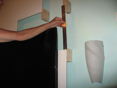

Step 6: Cut Foam Core
Cut your foam core to the desired shapes and sizes you need to completely cover the front and sides. Use a ruler to decide the exact size you need and again, make sure the foam core will touch more than one block at a time. Apply all of the front panels first, remembering to let the foam core overhang 1/8" on the sides. Then apply the sides. This will ensure seamless blended corners of your boxwood. (Thanks mom for the pose!)
Continuing to use the Loctite, glue the foam core to the 2 x 4 blocks. As before, make sure to hold them in place and let it dry overnight.

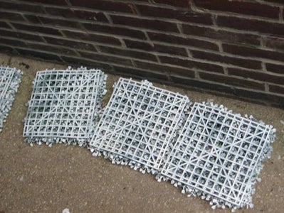

Step 7: Prep and Paint the Boxwood Foliage
Before starting, your artificial plant mats should be clean and dry. Give them a little scrub with sandpaper or a lightweight wire mesh brush. This will help the paint stick to them, as it tends to flake a bit when you attach them to the wall.
Cut the boxwood in to the desired final shapes and sizes using scissors.
In a well-ventilated area, apply plastic primer to your mats on the front and back. Fold the mats in half to get in-between the rows of foliage for better coverage. Then follow the primer with the color of your choice, guided by the directions on your spray paint for application and dry time.
** Be sure to get the sides and and in-between areas of the mats well coated with paint.

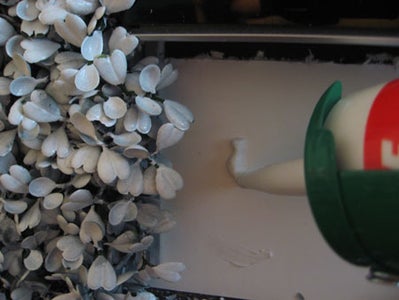

Once your boxwood is dry, use your Loctite glue to secure the mats to the foam core and let them dry overnight.
Some of the paint may flake off during this process; a little flaking is OK. However, if all of your paint starts to flake, then your paint either did not dry properly or the surface needed to be braised better and you may have to retouch them.
Keep gluing and attaching the boxwood until your finished!
