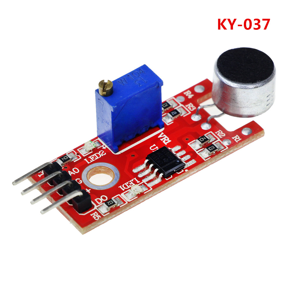

- 1 MIC module like KY-037 (image) but is prefered with AMP integrated like MAX9814 (image)

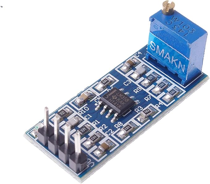

- 1 Amp module (optional) if you use KY-037 (image)

- MIC signal is connected to PA0 pin (this board must use 3.3v)
