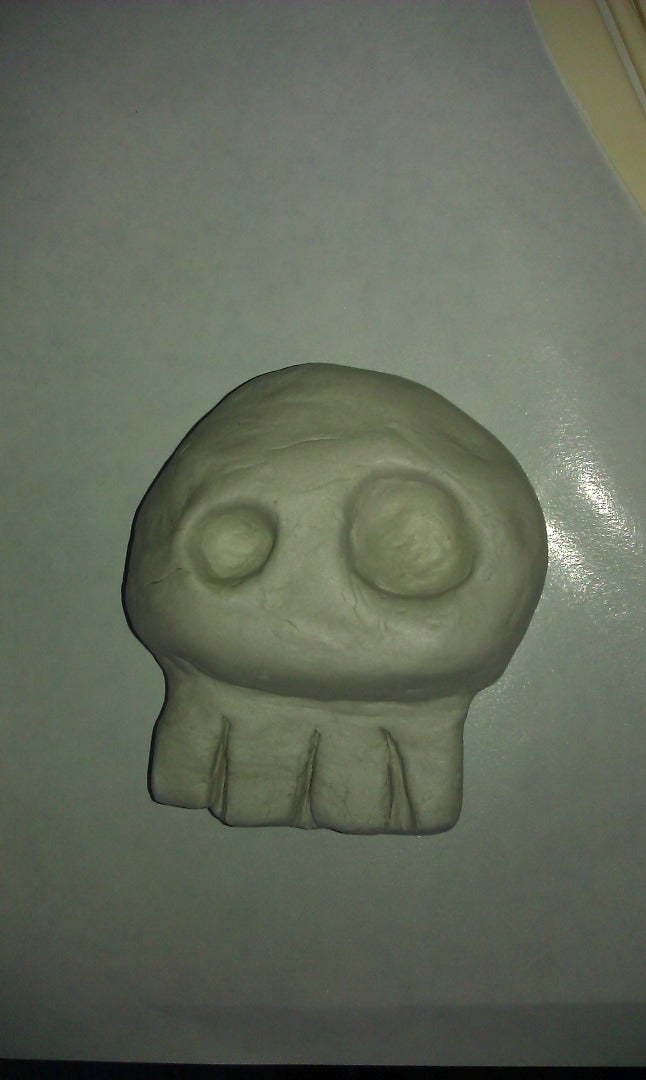

Step 2: Sculpt Your Original
  1. Using your air dry clay, sculpt your image.
  2. Allow to dry completely following manufacturers instruction. Remember though, the thicker you make your sculpt, the higher the chances it will take longer than normal to dry. This need a few extra days before i was comfortable that it was completely dry. So it is a good idea to give yourself plenty of time.
