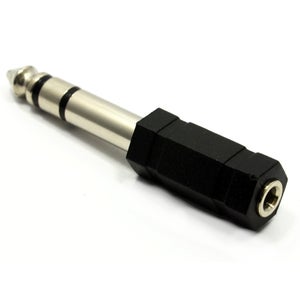

I wanted to have an audio input for external signal source - the MP3 player had these inputs available. Unfortunately I was not able to find any 3.5 mm audio socket, which could be mounted on the 8 mm thick box wall.
I decided to use for that purpose a stereo audio adapter 3.5 mm - 1/4", which I had available.I did a hole in the box wall, I soldered 3 flexible wires to the 3 contact rings of the adapter. Over it, from the internal side I put a small plastic tube (color marker), which I filled wit epoxy resin to fix strongly. I have checked the functionality of the audio socket using a headphone and 1.5 V battery.
