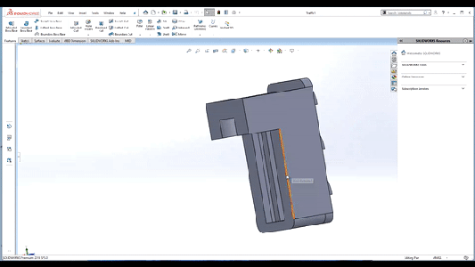

Step 1: Design Your Traffic Signal
The initial stage of the process involves designing a miniature traffic light. Any 3D design software will do; I've used Solidworks, but for simplicity, we recommend using Tinkercad, a free online design tool. First, construct a box to house your traffic signal. Additionally, a platform for the red, yellow, and green lights to sit on must be made. Don't forget to leave space inside the enclosure for the electronics.
The CAD and STL files for these pieces are attached below if you want to download them.

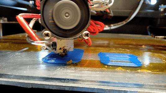

Step 2: Print Your Design

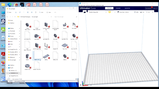

Once you've finished designing your traffic signal, it's time to print it. You can use any 3D printer that can process small designs. PLA filament is an excellent option for this project because it is readily available and straightforward to use. We suggest using a layer height of 0.2 mm for the best results.
STL files for the G-code preparation using any slicing software, are given in the above section. You can download those files.
Here, I have used PLA filament for printing these parts using a custom-made 3D printer.

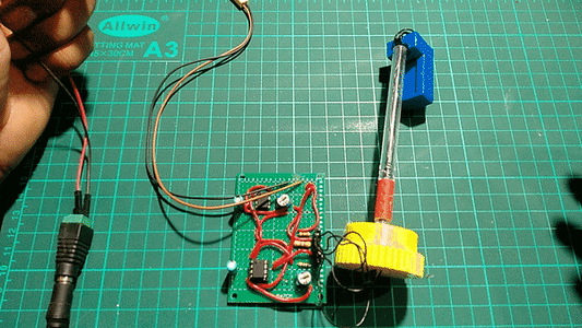

We have structural parts of our mini traffic light, now it's time to prepare the electronics part of the project. The main electronics components of this project are 555 Timer IC. Here we connect all the electronic components to the 555 timer IC as per the given circuit diagram. The circuit diagram for this project has been attached here.
  1. Prepare the circuit on the perforated PCB board.
  2. Solder all the components and connect them using single-strand wire.
  3. Check all the connections using a multimeter, it will help to resolve the loose connection problem quickly.
  4. Connect the wires with all three LEDs - Red, yellow, and Green, through the resistors.
  5. The wire should be long enough so that it can come outside the structural part and connect with the developed circuit on the perforated board through the header pins.
  6. Connect the female headers on the perforated board for the connection of LEDs.

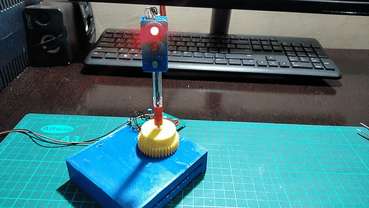

Step 5: Test Your Traffic Signal
The final step is the test of the traffic signal. By attaching the developed circuit board to a power source, you may check to see if the traffic lights are functioning properly. Here, I have used a 12V 2 amp adapter as the power source. In my case traffic signal is working properly on connecting with the power source.
But, Frequently, we encounter issues such as loose connections, improper soldering, incorrect component polarity, and others, which can cause problems in our projects. If you face such an issue, check it using the multimeter.
