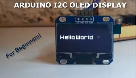

In this tutorial we are going to Printa text on the OLED Display using Arduino.

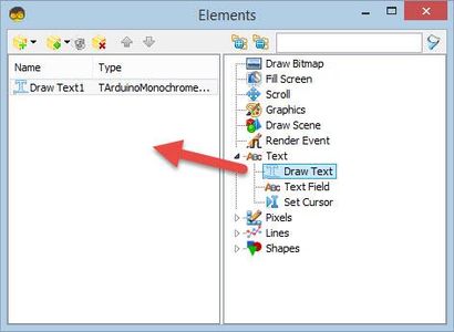

  • Add "OLED I2C" component
  • Double click on the "DisplayOLED1" and in the "Elements" window drag "Draw Text" to the left side and set in the properties window set "Size" to 2, "Text" to HELLO WORLD (Or any other text)
  • Optionally you can also set X and Y
  • Close the "Elements" window

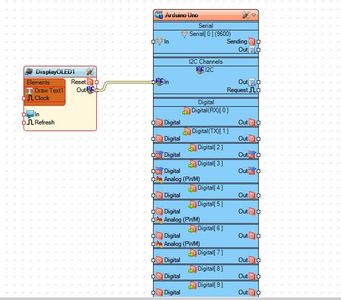

  • Connect "DisplayOLED1" I2C pin [Out] to Arduino board I2C pin [In]

If you power the Arduino module, The OLED Display will show the Text.
