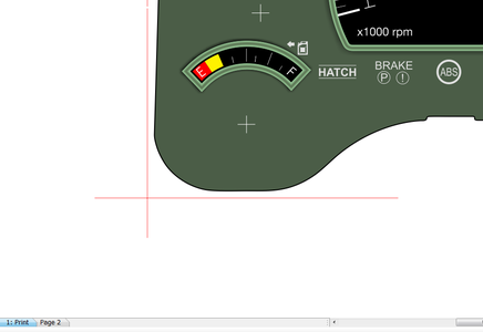

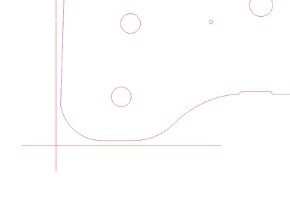

First, prep your artwork. You should have multiple pages / layers, for what is needed to print, and what is needed to cut. They should line up 100% in the file for this to work. That should be understood without saying, but it is key.
As you can see from the screen shots, I add an external cross-hair pattern, this reference mark is added at all 4 corners. As with many laser cutters, it is hairline vector art, and RGB red. The color should be different for the reference marks than it is for the final cut pattern.
Trim so the reference marks are to the very edge. I make mine long
and cut through. The edges do not have to be the best, we only care about the finished parts.
