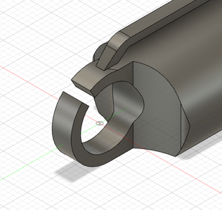

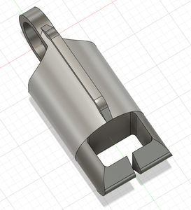

In Fusion 360, I started with the snap-fit clips. The clip itself and the notch it snaps onto should have complementing shapes. The tolerance between the clip and the notch also requires tweaking. They need to snap on securely, but still easy to remove and allow smooth movement.
Prototypes #1:
First, I created the notch as a small wedge with divots on its top and bottom. The divots were a bit too close together in my first prototypes and the material broke easily. 1mm worked for my later iteratios. The x-bevel on the side can help the clip open up more easily. For the clips, I created protrusions with the same cone-like geometry that matches the divots. I made four of them, with gaps of +0.2mm, +0.4mm, +0.6mm, and +0.8mm, all of which snapped on very easily.
Prototypes #2:
I added notches onto the clips so that they can snap onto one another to form a longer chain. However, dues to the added materials at the bottom of the clips, the clips became more rigid, especially compared to prototypes #1. None of them bent or opened up sufficiently.
Prototypes #3:
After evaluating previous iterations, I redesigned the clips to allow for more space between the protrusions and the divots. This restored the clips' snap fit function. The +0.8mm gap clip was found to be the best one. The shape of the clips were improved to look a bit more streamlined. For the notches, I tested different fillets. 1.5mm fillet worked best.
Final Design:
I noticed pretty obvious printing artifacts on the clips, due to their thinness. Therefore, the clips were thickened intentionally for the curvier final design. From there I derived an additional ending clip for the bottom of the chain. The notch is redesigned to fit three parallel snap fit chains.
The clips are printed with 0% infill, without support. The notch pieces are printed with 20% infill, without support.

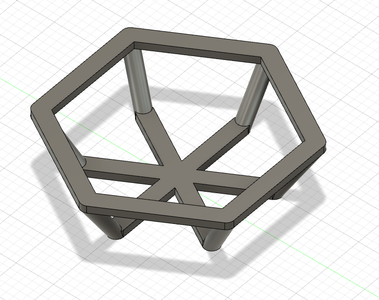

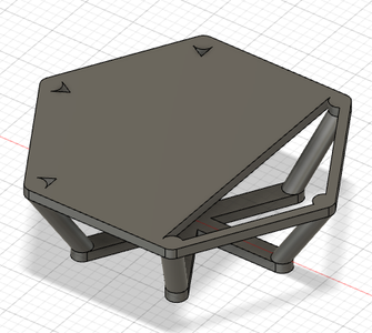

Create the hexagon links:

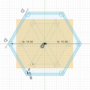

First, I used Circular Pattern to sketch six small circles around the origin, with a distance of 10mm. (Such values should be pre-defined as User Parameters, so that they're easier to adjust later on.) This is going to be the base for the link's posts/stems. I set their radius to be 1mm, resulting in stems with thickness of 2mm. Next, create a construction plane to sketch from, offset from the xy-plane by linkHeight+materialThickness (for mine it's 5mm+1mm), use Circular Pattern again to arrange six small circles but further away from the origin. Loft these six pairs of circles to create link stems. (I had to loft the circles without drawing a hexagon that intersects them, otherwise Fusion refuses to loft cylinders.) Then, on the 1st sketch, draw lines tangent to pairs of circles to create a star shape, and loft the star by materialThickness. On the 2nd sketch, draw concentric hexagons to create a hollow hexagon, and loft it too.

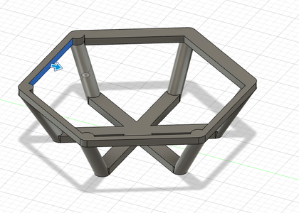

My triangle and circular links were created in a very similar fashion: draw the stem circles and loft; sketch out the base star shape and loft; sketch out the hollow polygon/circle on top and loft.
However, my initial parameters were too small, making the links far too thin. The links were later adjusted by modifying User Parameters or with Extrude.

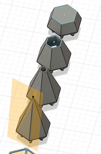

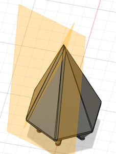

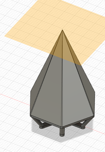

Create the spikes from the hexagon links:
Using a hexagon link created in the previous step, I filled the top hexagon using Extrude, creating a base. Use a construction plane parallel to the hexagon base, offsetted by spikeHeight (mine is 40mm), to sketch a point for the tip of the spike. Loft the hexagon base to the tip.
In order to create variations, in terms of heights and shapes, I chose to cut from the spike geometry. I used construction planes, offsetted 10mm apart.
The tetrahedrons from the inspo chainmail fabric were completely filled and solid, which contributed to a long print time (~10 hours during my test print). Due to the much larger size of my spike designs, printing entire solid geometries will increase the weight of the pieces significantly, and may cause overhang issues. Therefore, the spikes need to be transformed to shells.
Again, construction planes, using Plane at Angle now. I cut out and removed the "insides" of the spikes, leaving ~1mm thickness as its shell. The tops of the shorter spikes need to be added back. I did that by sketching a hexagon on the top surface and extruding it downwards.

Assembly failure led to a modified circular link design, though at that moment I forgot to consider overhangs from floating circular paths. For a polygon, edges between vertices are straight line segments, which can be suitable for unsupported printing. A circle essentially has infinite vertices and so requires more than the three support points I gave it. I don't think the filament likes to follow curved paths unsupported, either. Unfortunately, I'd sunk a couple of hours going through circular link iterations, before realizing the mistake mid prototype print.
After all that and after re-examining the tetrahedron chainmail, I decided to stick to only hexagons. The smaller hexagon links are taken from the tetrahedron chainmail's STEP file, though in hindsight I could've also just scaled my own links down. They would've been pretty much identical, anyways, moving on.

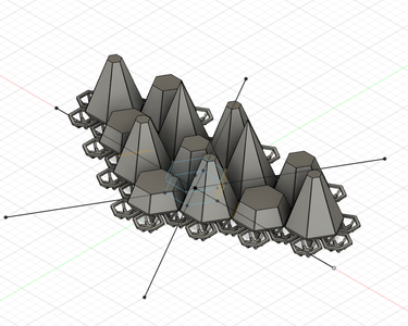

There were two main factors that affected the process. The overall shape of the headpiece, and the geometry of the links.
Most chainmail STLs I explored show rectangular patterning. However, it was not suitable for mine. I used a combination of circular patterning and mirroring to achieve the result. It is important to ensure that all components are at the same Z value. If not, the slicer might generate bad layers and cause print issues.
Prototyping with only hollow hexagon links took about 4 hours. It's around half the time of a full print. The result already looked really beautiful!
Lastly, I simply added the spike links, and adjusted their positions until they looked great. :D
The full headpiece design took over 8 hours to print. Printed with no infill or support.
