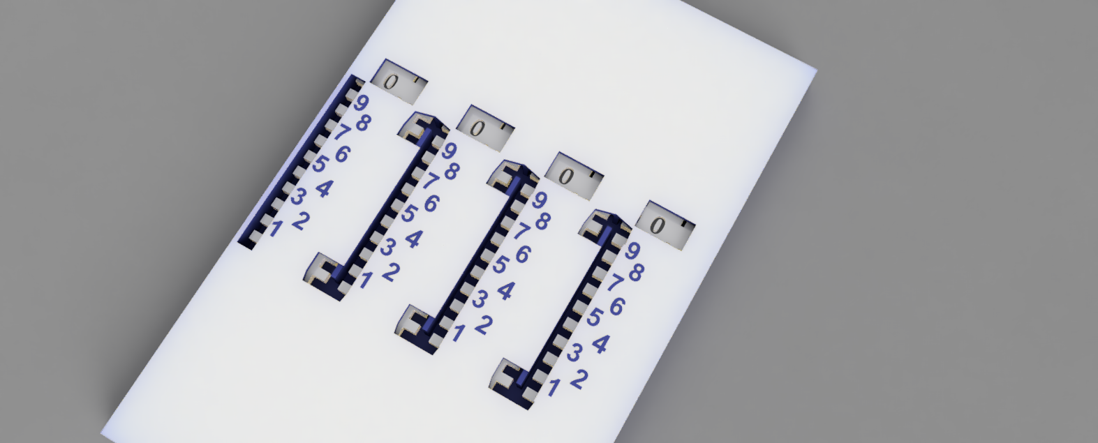

Step 5: Holes in Top Plate
You can align the holes of the top plate by using section analysis in the utilities tab of Fusion 360. Select the top plate, and create a section the thickness of the top plate. You may need to make this value negative. This will allow you to see through the top plate.
Digits:
Form holes for the digits by cutting a rectangle the width of the top plate over the "V" and wide enough to accommodate other digits on the same slide, then duplicating over the other slides. Watch out especially if you used staggered numbers.
The example has the hole at "0" by adding extra space above the slider. This is only for aesthetics.
Vertical of "cane":
The cutouts for user input can be created by first cutting open a section of eleven slots from the left edge of the leftmost slide. Duplicate this with a pattern to easily cover all other slides.
"Hook" of cane:
The hook of the "cane" should be added only on and after the second vertical cutout from above. They should be on both the top and bottom of the cutouts. This enables addition and subtraction from a single cutout.
The hole should start at the top of the hole we just created earlier and extending it to cut and include two slots from the right edge of the slide to the left.
You must also remove a portion of the separator at least the height of a space on the slider and from the top of the cane.
Refer to images if needed.
Step 6: Top Plate Numbering
The numbers for addition should start at the second space and count down from 9. You don't need a zero, as you won't add zero.
The numbers for subtraction is unnecessary as they are simply the numbers listed for addition subtracted from 10, but can be added.
The case is now finished.
