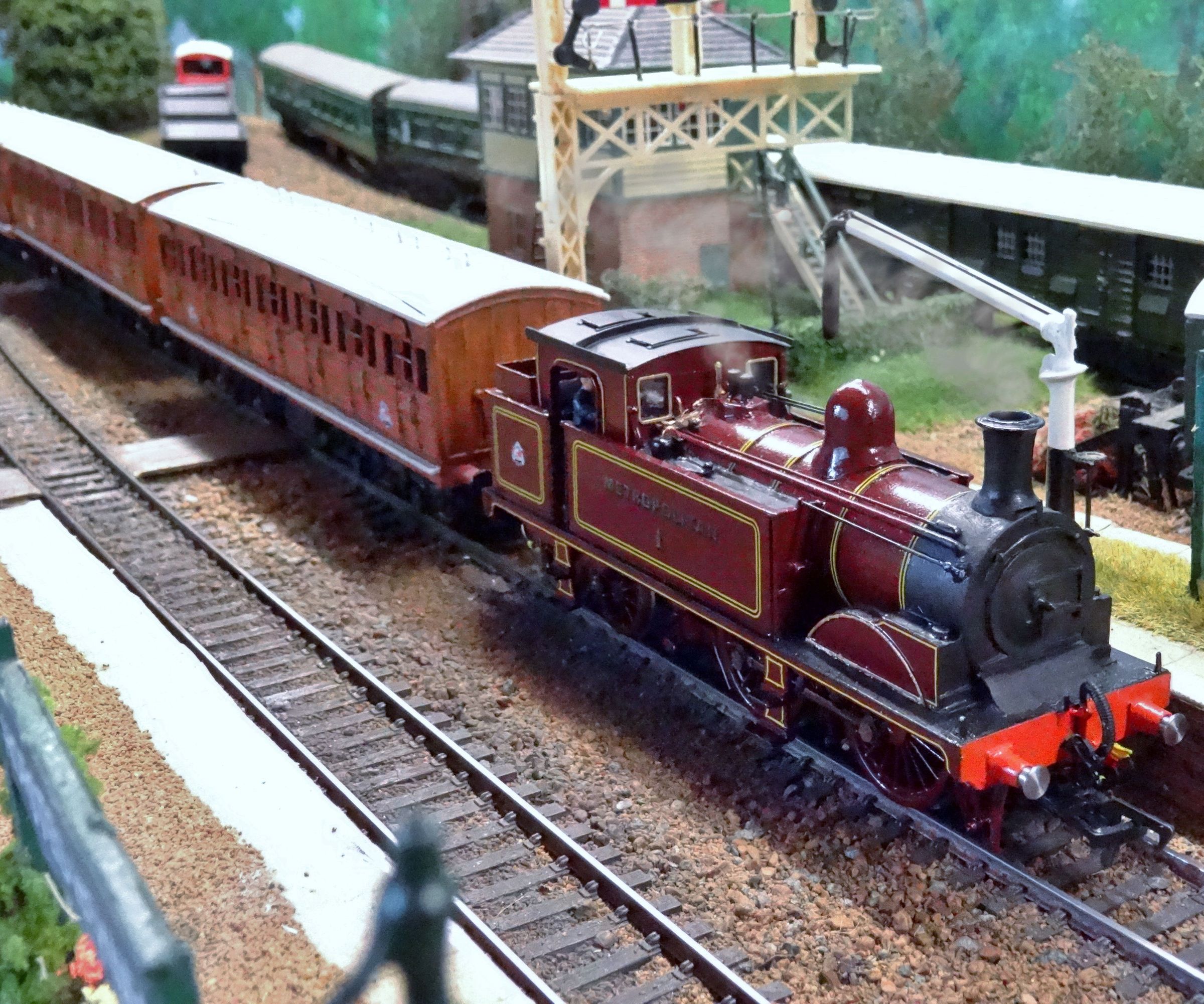

The second prototype arrived, the body was printed using Hubs,and printed in grey resin using a Form Labs 1 desktop printer, where as the detail or small parts were printed by Shapeways as I had an order to go in for some other parts for other projects.
I was very pleased how the prints came out, and the detail was clearly visible. So being happy (for once) I assembled the body. .
Step 4: Assembly...
The assembly, this was quite straight forward as the previous prototype checked that the general idea and fit was correct so went on the powered chassis with no problem, using the original mounting points from the old body shell.
Most of the smaller parts although not 3D printed were all made by hand using brass, and copper and ay spares I had to complete it.
Step 5: Complete + Testing
The body was fitted the chassis, and taken for a test run, where it worked well after a bit of weight was added which was designed in to the model to add weight if required.
As you can see from the photo's and videos the model as an unpainted prototype is a great tool to show people what 3D printing can do, and the print has done what it was designed to do, which was to allow others to buy and build their own model.
