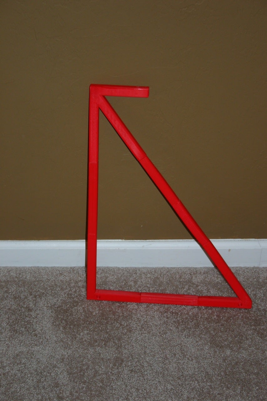

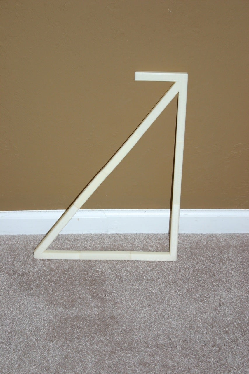

Step 4:
These are the uprights after being put together.
