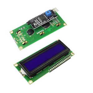

In this tutorial, we will learn to interface I2C LCD with STM32 Black Pill and program it using STM32CubeIDE and HAL libraries. Firstly, we will briefly introduce you to the I2C LCD including its pinout and connection with STM32 Black Pill. Then we will move ahead and program our board in STMCube IDE to demonstrate some basic functionalities that we can display on the LCD.

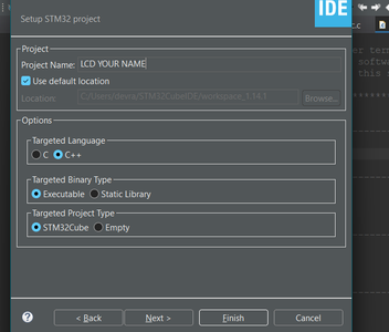

Add Name to your project and select option as shown in figure.

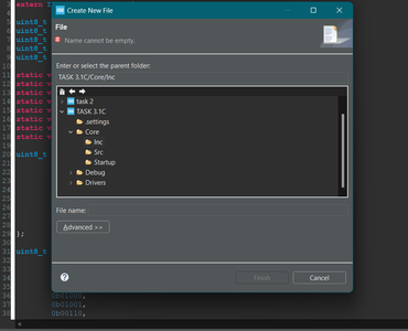

Step 7: INCLUDING I2C LCD LIBRARIES
As we are working on I2C LCD we have to include liquidcrystal I2C file for displaying our name on LCD
liquidcrystal_i2c.h
- Go to Core > Inc and create a new file called ‘liquidcrystal_i2c.h‘ Copy the following code from this link and save it to this file.
- made this change in line 58 to #define DEVICE_ADDR (0x27 << 1)
liquidcrystal_i2c.c
- Similarly, head over to Core > Src and create a new file called ‘liquidcrystal_i2c.c‘ Copy the following code from this link and save it to this file.

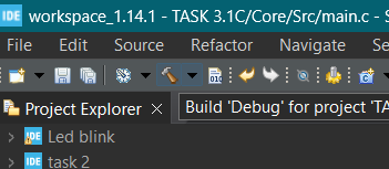

Step 10:
we will debug the code by the debug option as shown in figure.
and your file will be saved in STM32CubeIDE>workplace. select your project and copy its file Location.

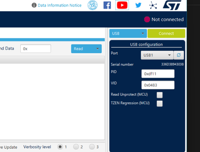

Step 11:
Now ,open STM32CubeProgrammer , and choose usb mode and connect your STM32 Blackpill with it.
Step 12:
Goto >erasing and programming.
Step 13:
In file path enter location of your saved programming file or browse for it.
Choose option as shown if figure.

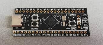

Step 14: Troubleshooting While Uploading
If it is not diplayed:
- try to reset your STM board by pressing reset button on it .
- or boot it by pressing snd holding BOOTO first and pressing NRST once , and reconnect your stm board and try to upload code now.
This will work for most cases .
