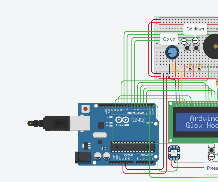

Step 2: Schematic Drawing
Before we start making this project, I wanted to show you how the schematic drawing will look like for this project. A schematic is a drawing or sketch of a circuit.
Step 3: Assemble Circuit
Now you can start making your circuit by using the following image above. Remember to make it exact because the code that will be given will be based on the circuit design and Arduino pins. If you want to change the pins possibly for neatness, you will have to change the code accordingly. If you are not using tinkercad and you are making it in real life, the following process is just the same but it's hands-on.
Step 4: Assemble Circuit (Continued)
Continue to assemble the circuit. I have broken down the circuit into 2 separate images, this way it will be easier to follow and assemble.
Step 5: Code
Now that you are finished assembling the circuit, you can now move on to the coding aspect. For those doing this project in real-life, you can open up your coding software and start coding. For those who are using tinkercad, right beside where it says "start simulation" there will be a place where it says "code". Hit that code button, then you will see how there are code blocks, you don't want the blocks, you want the text. Then you will see the section where it says "blocks" click it and then you can select the code option. Finally copy the code that is given to you. The place where it says lcd.print("YOUR NAME") you can print your name there or change up what you want the LCD display to say. All you have to do is change the code in the brackets where it says "lcd.print".
