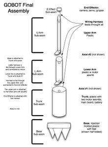

Step 1: Sketches
I had the idea for the design before I had the means to build it. It all started with paper and pencil drawings. I worked out the basic interplay of the parts and the way that the parts of the arm would fold into each other doing a number of these rough sketches. Not shown here are the many discarded ideas and experiments that led to this design that we decided to build.

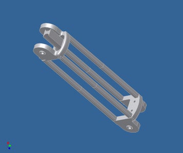

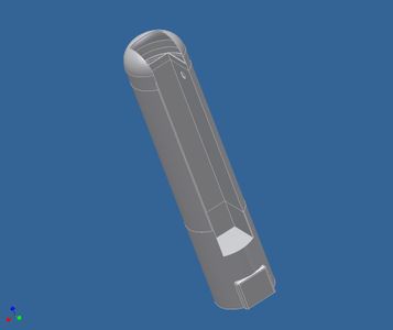

Step 3: 3D Drawings
The 2D drawings were used to design the entire arm in Autocad Inventor. I had help with this as I did not know this CAD package well. The CAD design was refined in several passes with the renderings used to look for the proper placement of the parts.

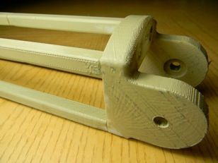

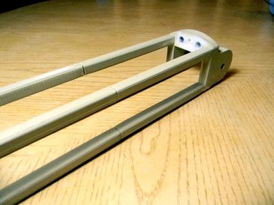

Step 4: Printed Parts
A 3D printer at TechShop (San Mateo) was used to print the parts from the CAD drawings. The assemblies were too big for the printer to make in one piece, so they were broken up into kit style parts and then glued together. After assembly they were dipped in acetone to harder the layers and then painted for color.

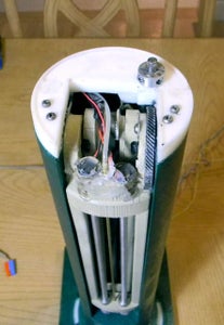

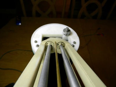

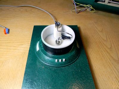

Step 5: Gears and Motors
The lower base is made of two parts; one turns on top of the other. Here you can see the two base parts and the rotation motor.

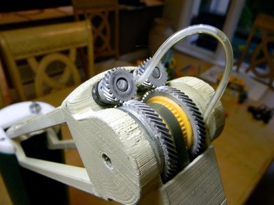

You can also see the way that the elbow and wrist motors are mounted at the shoulder and turn drive shafts into the helical gears at the elbow. The first gear set is hard mounted to the elbow and extends the lower arm. The wrist is operated by a toothed belt from the second gear and this extends and retracts the finger.

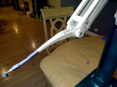

Step 6: The Finger
Here you can see the finger tip with it's small vacuum cup tip. There was a small vacuum pump in the body with a dump valve to allow the Go stone to drop when you had the correct location. You can see the vacuum line going from flexible to hard line in different parts of the arm and around the joints. The layers from the printer are very visible where the angle of the arm is small.

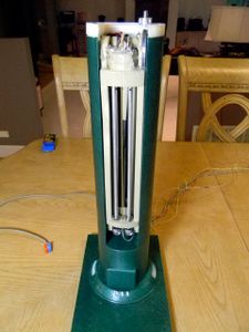

Step 8: Testing
When the unit is assembled, the arms fold into each other and then into the body.

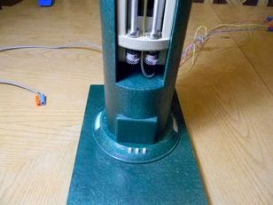

Step 9: Working
The shoulder motor is mounted in the base of the body with a drive shaft leading up to the gear that lifts the main arm.
The finished arm was able to pick up go stones and move them around.
