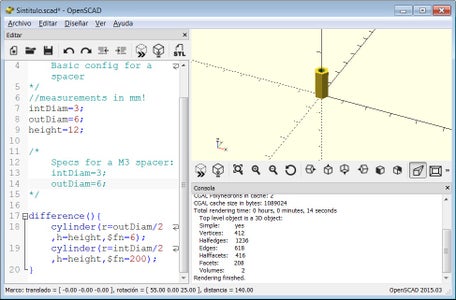

What to do?, I decided to use OpenSCAD, a parametric modeller and super lightweight, this code is for a M3 Spacer of 12 mm of height, change the dimensions for you needs, let's do it!
  1. Install and open OpenSCAD
  2. Copy and paste this code
  3. Set height to your needs (or dimensions)
  4. Press Render (F6)
  5. File->Export->Export as STL
As you can see the code is simple, very short and very useful.

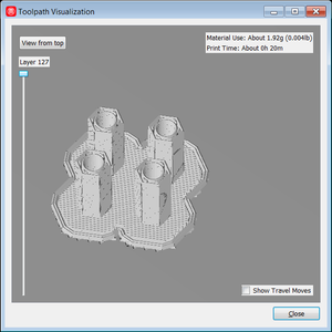

Step 2: Time to Print

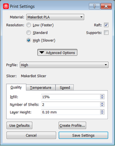

This is a very crucial step, I use a Makerbot Replicator 2, for this machine I need the Makerbot Desktop Application.
  1. Open the Makerbot Desktop App
  2. Drag and drop the STL generated in the step before
  3. Create the number of spacers of your preference (ctrl+c and ctrl+v)
  4. I highly recommend high resolution (see image for more information), you can play with this parameters in your printer software. (Note: Check the temperature and speed, Makerbot Rep. 2 use PLA)
  5. Enable rafts (to avoid curling)
  6. Click save settings
  7. Go to Export Print File

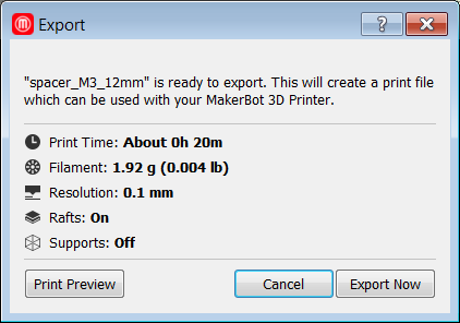

  8. Check the time and total of material of the model
    1. Clic "Print preview" if you have doubt of your model
  9. Click in "Export Now"
  10. Copy the .x3g generated file to the SD of the Makerbot and start the printing process.
Remember, always exist a millon of different ways to print something, experiment with the parameters, don't stuck with one configuration.

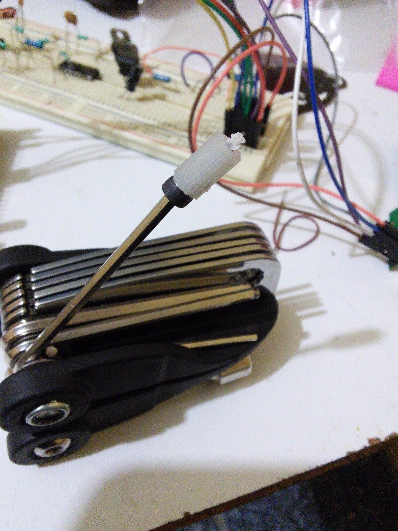

Step 3: Making the Thread
If you see closely, you can note there's no thread in the spacer!.
Don't worry, we can make a thread in a easy way, for this we will need a M3 screw of enough lenght (10 mm for the spacer of the photo), an allen for the screw and a tweezers to hold the spacer.
  1. Try to rotate the screw in the spacer with careful and a little force by hand
  2. Now take the allen key and continue rotating the screw, if you need help you can use the tweezers
  3. Continue until you pass the spacer or the screw head touch the spacer
Sometimes you will need a little of extra force, if the screw have a part in the spacer, don't worry, you can apply a lot of force from this point.
