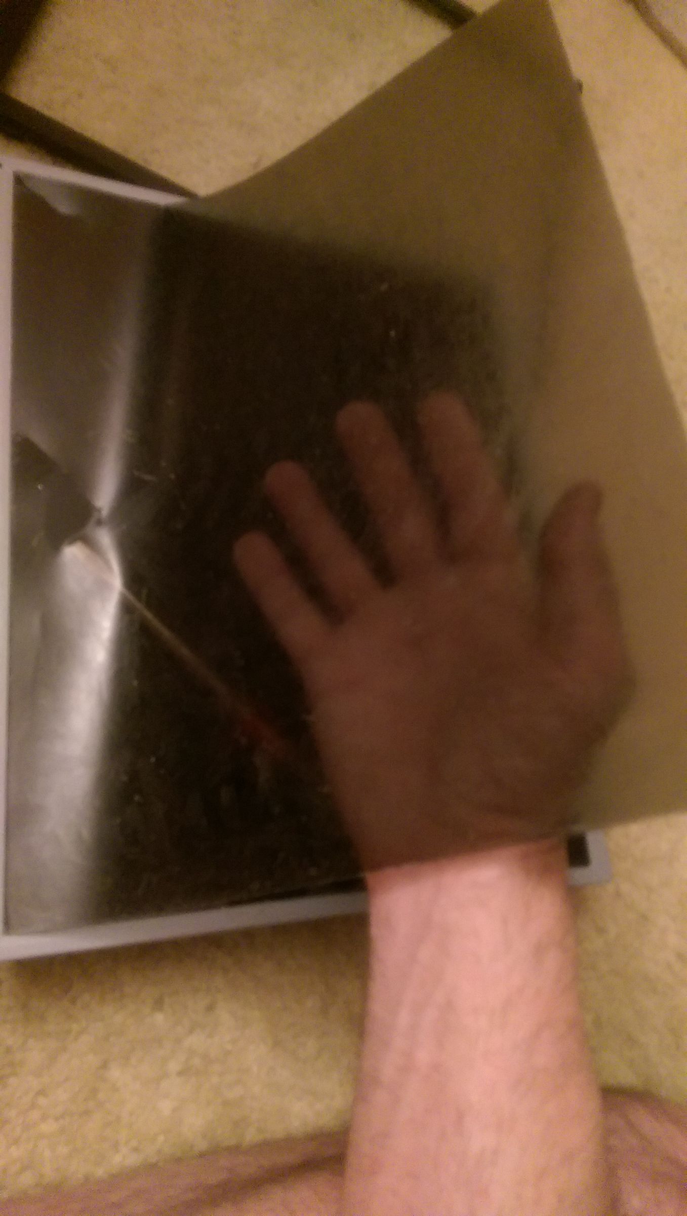

Step 2: Cut the Polarized Film
Most LCD monitors have two films on the glass - a polarized one to filter out the light you are not supposed to see, and a frosted anti-glare film. The anti-glare film we don't need, the polarized one we do - it is used for the glasses.
So, grab you cutting tool and cut the films along the edge. Don't be afraid to press, metal wont scratch the glass, unless there is sand or other abrasives on it.
Then, start peeling. Make sure to save the polarized film, also remember the orientation.

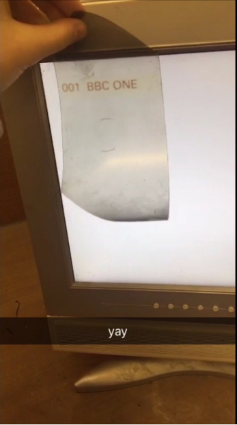

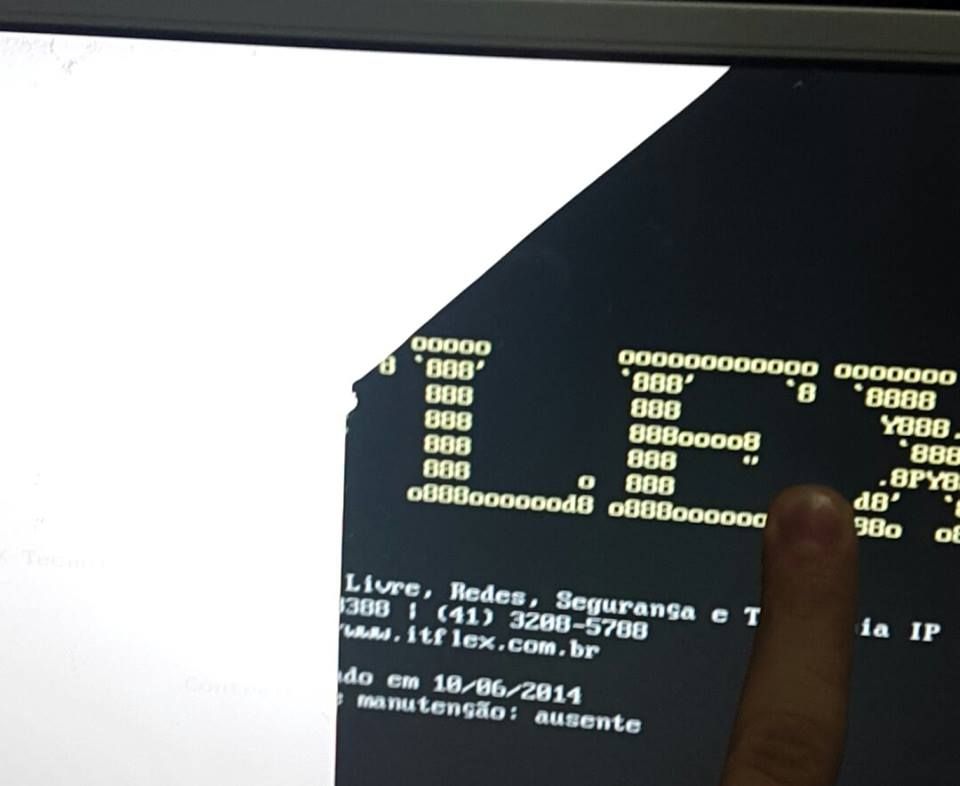

Step 4: Monitor - Done
After cleaning the adhesive, assemble everything back the way it was. Before even making the glasses, you can test the monitor with the polarized film!
Notice how the upper left corner looks clear, because it has the anti-glare film removed. That is the part we are going to use to make the glasses.

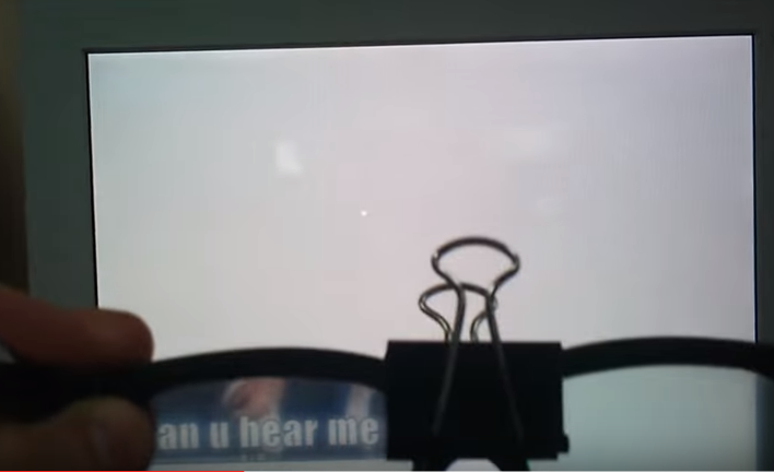

Step 7: Reassemble Glasses and Enjoy!
Finally assemble the glasses and you are ready for some fun!
People might think you are crazy, staring at a blank white screen wearing sunglasses!
But I guess that makes it even more fun!
