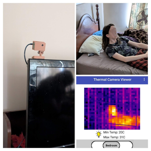

Now if grandma is not answering her phone, you can see she's just napping in her recliner!

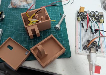

Step 1: Prepare the Sensor

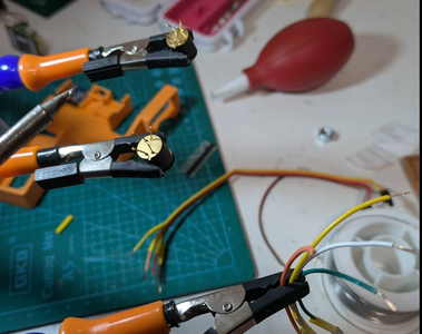

When soldering the sensor you should be very careful, and double-check yourself! The sensor is pricey and can be damaged by applying voltage to the wrong pins. (if you bought a version mounted on a breakout board it's easier, the pins will be labeled, but you'll need a bigger housing)

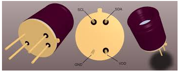

Attach short leads to each of the 4 pins, as shown in the diagram. I like to add a bit of heat-shrink tubing around the connection as well, though in a project this simple it's not really essential.
Use image search to find wiring diagrams and pinouts if the photos above are not sufficient (they probably aren't)
GND goes to the ground pin on the ESP32 and VDD goes to the 3V output pin (NOT the 5V pin! doublecheck...).
SDA and SCL get connected to the appropriate pins on your board - for mine, it's pins D4 and D5, but the ESP32 Supermini form factor comes in a few different flavors so check your own board, and modify the code as required.
Once you've doublechecked the wiring, check it again before applying power...

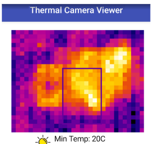

Important:modify the "camNum" value for each board you load! This identifier is used not only with ClientID but also to identify the camera when you're viewing the page it serves. (yes I should make this better)
Assuming the code compiles without error, connect the board to your computer, and upload the code. Watch the Serial Monitor at 115200kbps for startup and troubleshooting info. If it can't connect to the camera, try one of the example sketches that come with the camera library. Doublecheck your SDA and SCL links, both in your wiring and in the code - the pin numbering can be confusing!
If it gets online and all is well, point a web browser at the IP address it gives - and enjoy! You should get at least 2-3fps - higher frame rates are possible, but these sensors get significantly more noisy when you boost their transmission rate.

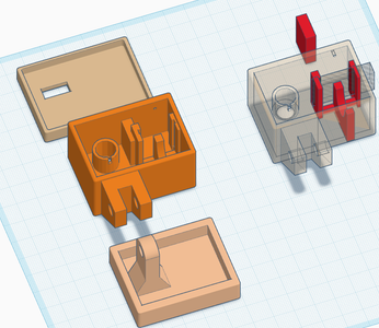

Step 3: Assembly
Even if you don't have a 3D printer, you may find one available at a nearby public library. Alternatively, I suggest looking online for a local 3d printer or maker group, you'll likely find someone happy to help. Or there are many commercial services where you can get small objects printed affordably.
If you're crafty, you can easily make a housing for this project yourself - out of cardboard, foamcore, Lego, whatever you like.
3D print files available here via TinkerCad. (includes an alternate, unfinished design allowing for the power plug to come in from the side, for wall mounting)
Step 4: Placement

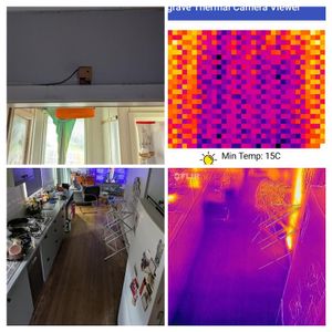

The ideal range for these cameras is between 1 and 4 meters from a subject's usual location in a room (a bed, a recliner, etc) though they can certainly cover a wider area, like a kitchen, with reasonable clarity.
Be aware of heat sources - a sunlit wall, a furnace vent, an oven. For example, there was a table in my father-in-law's living room perfect for the camera, but from that angle, the furnace was right behind his recliner, so it would have been hard to make him out from the background in cooler months.
You can use a heat source with the viewer to get an idea of the field of view for your camera - I just heated up a saucepan on the stove and moved it around the area while looking at the output.

Most obviously, the camera puts up a basic web server and offers a page with an embedded Javascript applet that handles rendering the data. If you have a link to the local network somehow - a VPN, a Tailscale account with a client running on their end - just use that. (current plans are to include a feature in the web page code to add links to other cameras in the network)
