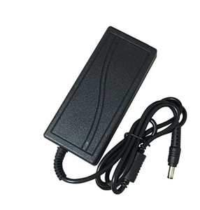

Step 12: The Power Supplies
I used 48V, 120W power supply adapter for the big light and 12V 2A for the small one.
The power supply output voltage should be below the voltage needed for the LEDs since my circuit is a boost converter. But the voltage shall be no more than three times lower than the LED voltage.
Each LED I used has an output voltage of approximately 9V. The small light has two LEDs in series - 18V, so 12V was a very common and it was easy to get voltage adapter for the power supply.
The big light has 8 LEDs in series - 72V total. I used 48V power supply, which is a common voltage. 24V was too much on the low side.
