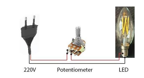

Step 1: Understanding the Schematic
The circuit is very straightforward; I need to add a potentiometer in series with the LED. You may argue why I did not use a PWM controller, Well it adds ripple to the output light and the PWM circuits are usually large enough to fit on a small desk lamp. Moreover, they are commonly used for high wattage applications.
The potentiometer is a variable resistor whose resistance changes based on the turning of the knob. Thus the brightness control is very smooth.
At high resistance, the brightness of the light is low
At low resistance, the brightness of the light is high
Since I am using low-wattage light, this simple setup with a 6-pin potentiometer is enough to handle the load.

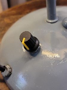

Step 2: Drilling
The first thing we need to do is place the potentiometer properly. I used a 0.25-inch drill bit to make a hole in the metal body.
Then placed the resistor and fastened it with a nut.

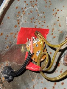

Step 3: Connect the Potentiometer
Cut the wire connected to the lights. Take the live wire(red) and connect it to the middle pin of the potentiometer. Connect the led wires as shown in the diagram. Add proper isolation. I used some scotch tape and glue to add isolation.

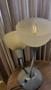

Step 5: Complete
The light works perfectly with no heat issue. I prefer this over the PWM controller since it adds no ripple to the light. The control is also very smooth!

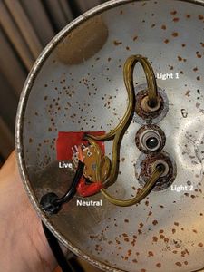

Step 6: Safety and Protection
Please only try to recreate this if you have good knowledge about practical electronics. Working with mains voltage can be dangerous.
I glued all the connections using a hot glue gun for further protection. This completely insulates the wires.
Also, if you are using a metal lamp, then please make sure to connect its body to the ground, as shown in the picture.
