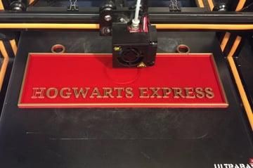

Step 11: Optional / Additional Techniques
Please note that the picture above shows post-processing on a model that is not related to this instructable!

Personalisation by pausing at height
If you would like to personalize your broken part by giving it your own touch while repairing, you might be interested in the "pause at height" method, to change colours of filament throughout the print. You can use this function to create rows of different colours in your print, or make letters pop as the images above show.
