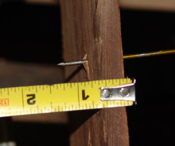

Step 4: Dart
Now you need something to shoot. Wooden or bamboo darts are fine, but because of their low density and mass they cannot fly as far as steel nor penetrate as deep. So, I recommend that from an all-wire coat hanger, you cut out the middle straight section which is about 15" long to use as a dart. Then, make a cone (perhaps a neater one than is pictured!) out of duct tape which fits around the dart. Place the cone into the conduit, and mark with a Sharpie where it meets. Cut at or just beyond this line to make a properly sized cone. Slide this on, and affix with a generous amount of duct tape (as is shown in the photo). This cone will both catch the air which propels the dart, and stabilize the dart during flight. On a grinder, or with sandpaper/file, grind the tip of the dart to a sharp point.
