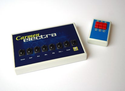

Whether you are just making a flashlight or designing the greatest microcomputer-controlled device, making the finished product look professional adds an enormous amount to the 'wow-factor' of your finished gadget. The big device in the image is nothing more than a switch box to control some lights in a school production of "Carmen" (hency the tacky pun with the name), but it looks like a commercial shop-bought product because of the use of a few simple techniques described here.

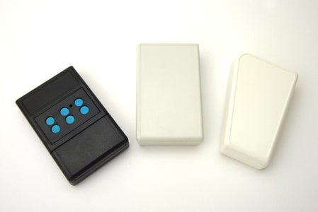

Gone are the days when you have to choose a boring black square-edged enclosure for your device - now there are hundreds of choices, some with lovely smooth edges and even rubber hand grips. Go to somewhere like Digikey in the US or Rapid in Europe, and choose a box that is the right size and look for your project. Ideally, get one with a recessed area on the front panel for an overlay - in this image, you can see that each of these has a front panel area that is recessed by a fraction of an inch.

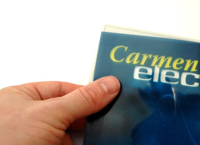

Finally reverse the design (most graphics programs have a "mirror image" function), and print it out on an OHP transparency sheet. If you can't find out how to reverse the image in your package, you can probably tell your printer to do this for you (many inkjets have this function built in to allow you to do things like T-Shirt transfers). Failing that, you don't really even need to reverse the image - but if you can, it just means you can turn the transparency over after printing, and the ink will be on the reverse side of the plastic, and will then stay protected for life and not scratch off. Alternatively, you could use a 'fixative' spray on the ink (like a lacquer), or stick another clear sheet of OHP film on top. Here is an image I have printed reversed from my color laser (the photo here shows it turned back around the right way). If you are using a laser, make sure you get a proper 'laser/photocopier' transparency that will withstand the heat, and if using an inkjet, use a proper inkjet transparency that is coated to make the ink stick.

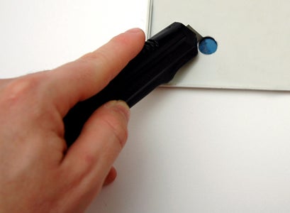

Step 4: Cut Out Holes
Next, turn your front panel over, and use a sharp knife to cut out the transparency showing through the holes. This provides a cleaner hole than just drilling though both transparency and the box at the same time.
If you are using displays in your project, you can leave a clear window in your design for the display to show through. This way, cutting out a slightly oversized hole doesn't matter either, as the edges of the ink will hide the rough edges of the hole. With a bank of square buttons like the remote control in the first picture, again the square hole can be oversized - just make sure that you cut out the square hole in the transparency before sticking on, use a sharp knife and ruler, and make it a little smaller than the cut-out in the box - this again will hide the rough edges.

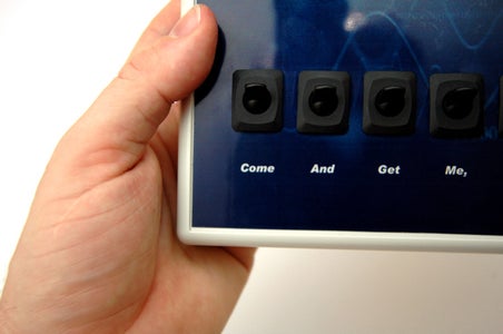

Now turn it back over and push through the components - panel-mount components will have a nut on the reverse side to fix them, which can be tightened now.
Always choose components like these switches below which have a lip around them, as this will hide an oversize or roughly-cut hole in either the plastic box or the transparency.

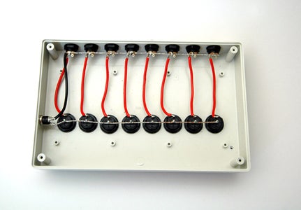

Now you wire up your components / circuitry etc. Can't tell you how to do this, as it will depend on what you're building! (Hopefully you have your own brilliant idea for a gadget by now that could use this technique!). This is a simple switch box for lights, so wiring was very easy.
