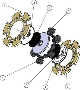

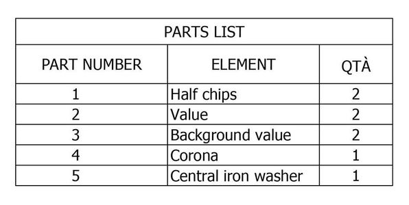

1.      Be modular: I created the different parts of the chip so as to print as few different pieces as possible. The complete chip consists of 5 different parts of which 4 are 3D printable The value of the chip fits into the half chip and then everything fits again in the crown and the same is done on the opposite side.

4.      The chips have the same dimensions as those of the casinos and as regards the weight I have foreseen the insertion, when assembling, of an iron washer to obtain the necessary weight. The authentic ones have a weight that can vary between 8 and 10.50 g each. With the iron washer these weigh about 9.2 grams.

Assembly instructions: I followed this sequence:
·        I inserted the background of the value in the value and then the whole in the half chip, helping them, if necessary, with an object (plier) to press the parts well in their place, obtaining part A.
Part A is made up of parts 1, 2, 3.
Nothing prevents you from using other editing sequences.
·        Part A I set it in part 4 (Crown). Here, too, I helped myself to get the various joints in place. In particular, I used a pliers to fit the various cubes of the crown with the external part, you can tighten tightly so nothing happens.
·        The maximum size of the washer is 24mm, I used one of 23.80mm and thickness max 1.70mm, I used 1.55mm
·        In the part thus obtained I inserted the iron washer and I closed the whole with another part A
