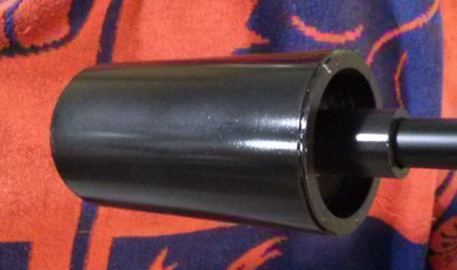

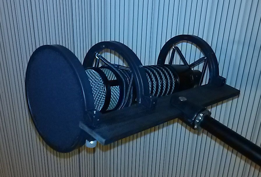

If you go with a studio microphone they can run from $100 to several thousands of dollars. Most will find that a Electro-Voice RE 320 at $300 would be at the upper range of useful at a pod-caster level, but what I use. Because mics are dependent on your voice I would recommend that you test it with headphones at a local music store to see how that mic renders your specific voice. You will need a pop filter and a shock mount. See my other instructable on this. Once we switched from just an audio podcast to the video and audio we chose to use the shock mount and pop filter that were professionally made.
We are going to hi-def for our productions and now a few more things will show up in the frame. Since hosts on our shows tend to be using the computer a lot, a boom can get in the way for a mic. Using a piece of oak and a toggle bolt (sometimes called toilet bolts), I made a base for the shock mount of the RE-320 that keeps it low enough for my desk height.

I hope this have given you some ideas on how you can add production value to your home studio and produce a quality podcast at least technically. If you check out my other instructables, you will find one on how to make a shock mounted mic stand and pop filter that you should also have for quality in your completed projects.
