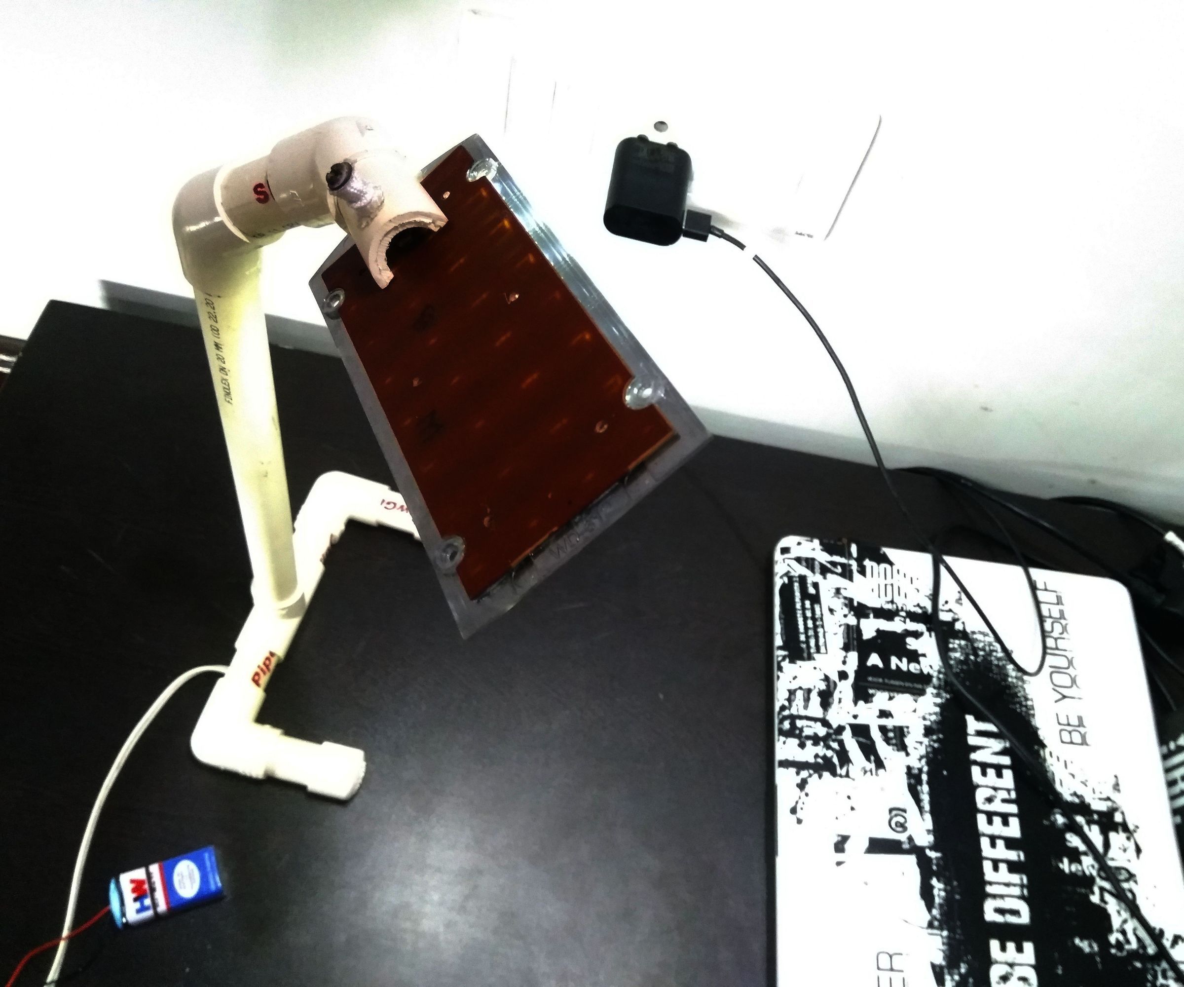

Step 5: Views of Mechanism in Different Angles
Complete image of mechanism
All the parts are attached as usual
single stepper motor control a plants we require only more mechanism for planting the solar plates.
Step 6: About Mechanism
These half circle frames are fixed in the solar frame.
See the figure of excel – excel attach with stepper motor and connect to the half circle frame.
Half circle frame teeth are attaching to circular excel teeth. Rotate the stepper motor than change the angle of solar plate according to micro-controller programming. These programming is based on angle of sunlight.
Three circular warm teeth are shown in three different view. Circular teeth are installing in excel for rotating the half circle teeth, and they are attached with solar plates for changing the angles.
Finally, whole process is applied the solar plate generate approximate 30% maximum current than general normal solar plates. So, it is more beneficial for solar plants. We add solar plates in the excel approximate 100 or more.
