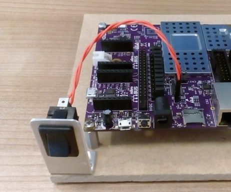

Step 4: Building a Bridge Cable
We need to build a cable to bridge the Dediprog to the Creator CI40.
The Creator Ci40 can be held in reset by connecting the SYS_RESET# pin on CN21 to GND in the programming lead.
It is recommended that a low value resistor is used to prevent damage to the Ci40 board. We used a 100 ohms resistor in this example
CN21 is a 6 pin (2 row x 3 pin), 0.1” (2.54mm) pitch header, part Harwin M20-9760346, and a variety of connectors will mate with it. Individual jumper cables can also be used
The circuit of the SF100 to Creator Ci40 programming lead is shown here
