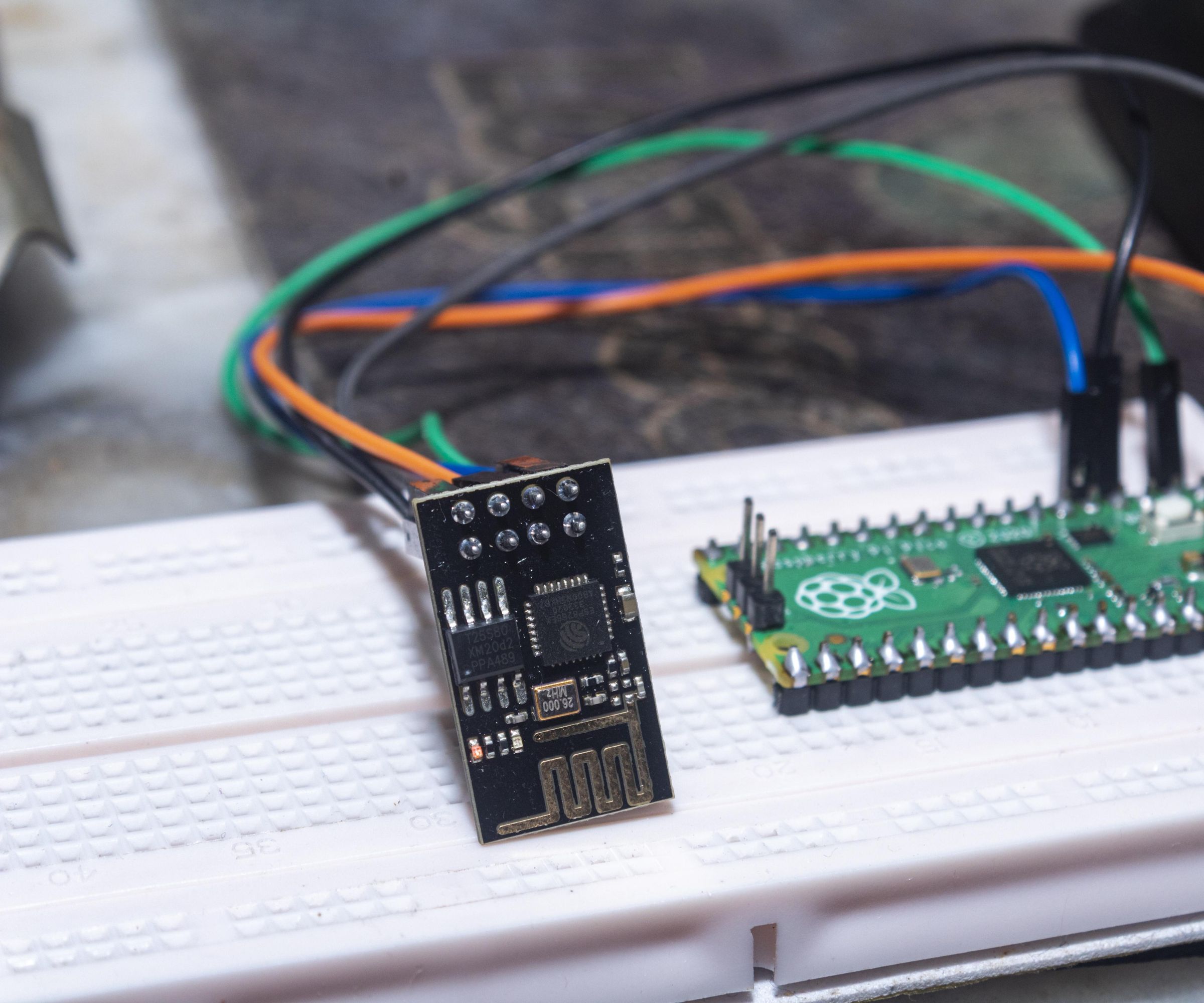

Step 1: Connect FTDI With ESP01 According to the Diagram Given Here.
Note - FTDI should be in 3.3v mode.
Step 2: Before Uploading the Code.
Before uploading the code, press and hold RST button then press GPIO0 button while holding RST button. Then leave RST button then leave GPIO0 button.ESP01 will go into programming mode now.

You'll see that ESP01 is connecting to the WiFi network. It will provide an IP address . Copy and paste it to the web browser. Connect an LED to GPIO2. You can now control the LED using the web interface.
