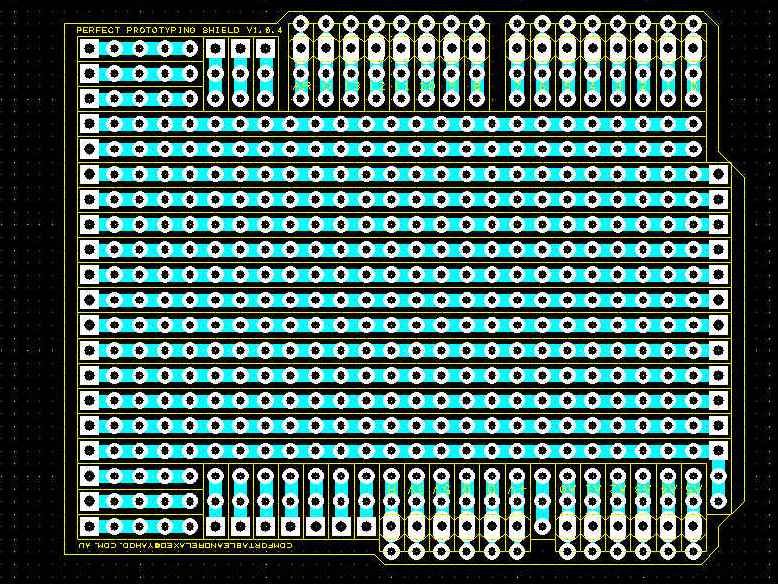

PCB was designed using free designSpark software by RS components and manufactured by SEEED Studio. Because I ordered other boards and parts at the same time, I paid around $23 for 10 of this PCB (worth if for me, as I made up some of the spares as gift kits for friends).
Alternatively, you can use the supplied .pdf file to do the toner transfer method and make your own.
