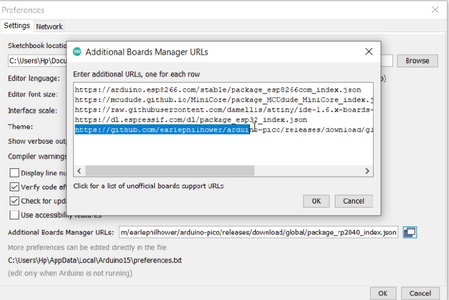

Open the Arduino IDE and put this code in the preferences section under file menu this is the link to the GitHub page of the maker: https://github.com/earlephilhower/arduino-pico/releases/download/global/package_rp2040_index.json

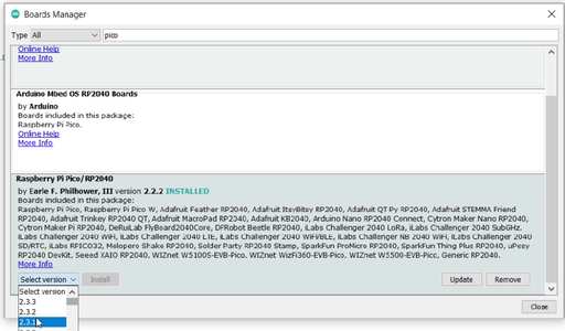

Then go to the board manager section under the tool’s menu and Download/install the PICO boards.
This will automatically download all the required files, examples and compatible libraries (total size of download is > 300MB).

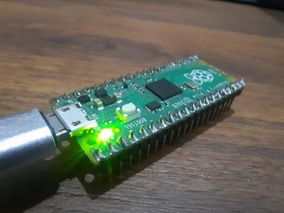

Step 3: How to Initialize:

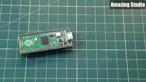

First of all, press BOOTSEL button and then plug the USB to your PC. Raspberry pi Pico will appear as mass storage device. You can store any program in the flash memory directly burning with UF2 file.
Step 4: Programming Using Arduino IDE:

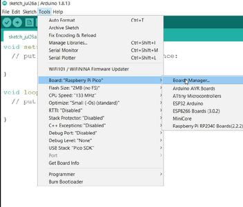

From the example section upload any sketch to PI Pico, I am using Blink sketch here for demonstration purpose.

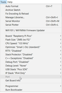

In the tools section, choose board as Raspberry pi Pico, but here port is not available for the first time. Don’t panic just click to upload the sketch.
Sketch will take quite a longer time to upload than Arduino board, due to its premature drivers. But after some time, you can see the action in the compiler below.
Step 5: Completion:

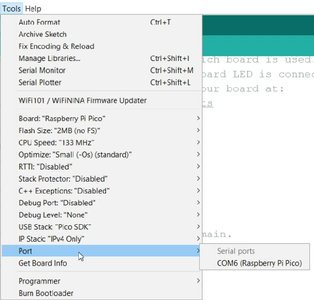

After that you can plug raspberry pi directly to your pc without pressing BOOTSEL button and allows to program with proper COM port.
It will not appear again as mass storage unit and the COM port is now available.
