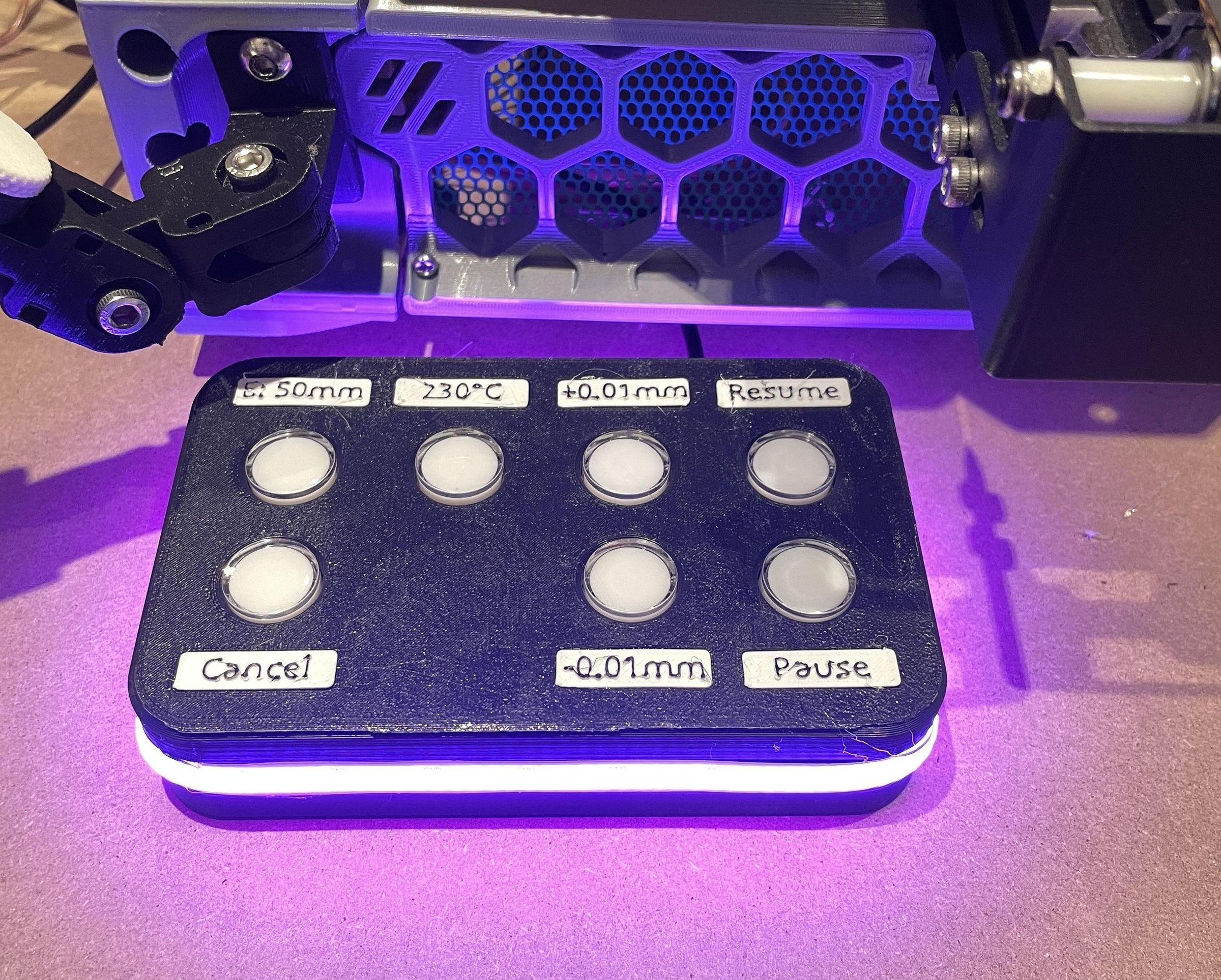

I wanted to build a programable macro pad after seeing so many out there. One of my main goals was to avoid using multiplexing on the switches. I didn't want to increase complexity more than I needed to, or order any diodes.
Another big reason to make this was so that I could completely design how it looked. There are lots of options out there for tons of different macro pads but I wanted one that felt like my own. The case is something that if you want to go wild and re-design I think it is a great opportunity especially if you are new to 3D modeling and printing. As I'm not using a circuit board you are really free to move any of the components where every your heart takes you. Or you can use the same case I did, I've liked it on the next page.

Step 1: Make the Case
If you are printing a case start your case prints now.
If you are designing your own case I would recommend print just the parts that will interact with components. Things like the holes for the LEDs to make sure they are the right size to hold the the LED securely. Also the mountings for the switches, make sure they fit tightly so that they don't rattle around when you use them.
Here is a link to the case that I made for this project. I have also uploaded an STEP file. This means you can open the model in a program like Fusion360 or Solidworks, (others work to but I have only worked with those), and see the entire design process/structure and make changes to the dimensions that you need.
Step 2: Put Everything in the Case
Because these are case mounted switches the case needs to be ready, or at least the top of the case, before you can move onto the next step.
Snap all the switches into place along with the LEDs. If your encoder came with headers you'll want to clip them apart and then de-solder each pin to leave an open place to connect the wires.
Step 3: Soldering
For wiring I've included the wiring diagram that I used for this project, I've left off the pin numbers as you can use what ever feels right for your project, any pin will work for any of the buttons/LEDs/encoder. The only pin I would avoid using in the Teensy is pin 13, it is tied to the onboard LED.
The basic run down is I ran a bare wire around to all the components and connected it to the ground on the Teensy. Then added a wire between each component and the corresponding wire on the Teensy. Take your time, but know if you mix some of them up its easy to fix in the code later (I swapped some of the wires, you'll be able to see in the code where I had to swap pins).
By the time you are done you will have a nice nest of wires that can be tucked away in the case.
