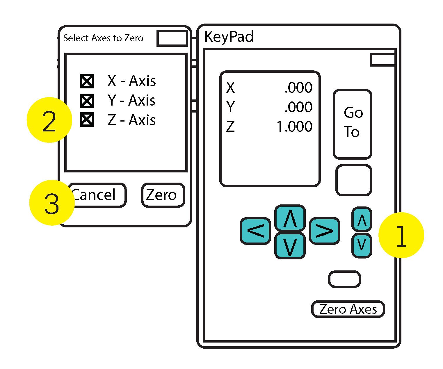

Step 1: Set a Z for an Air Pass
- Jog the spindle a few inches above your material.
- This must be higher that your material thickness.
- Use an even number, like 2".
- In the KeyPad dialog, select Z- Axis only.
- Click Zero.
- Confirm in the KeyPad dialog that Z has been set to 0.
- This will set Z0 2" above your part. After the air pass, you'll enter the correct Z0.

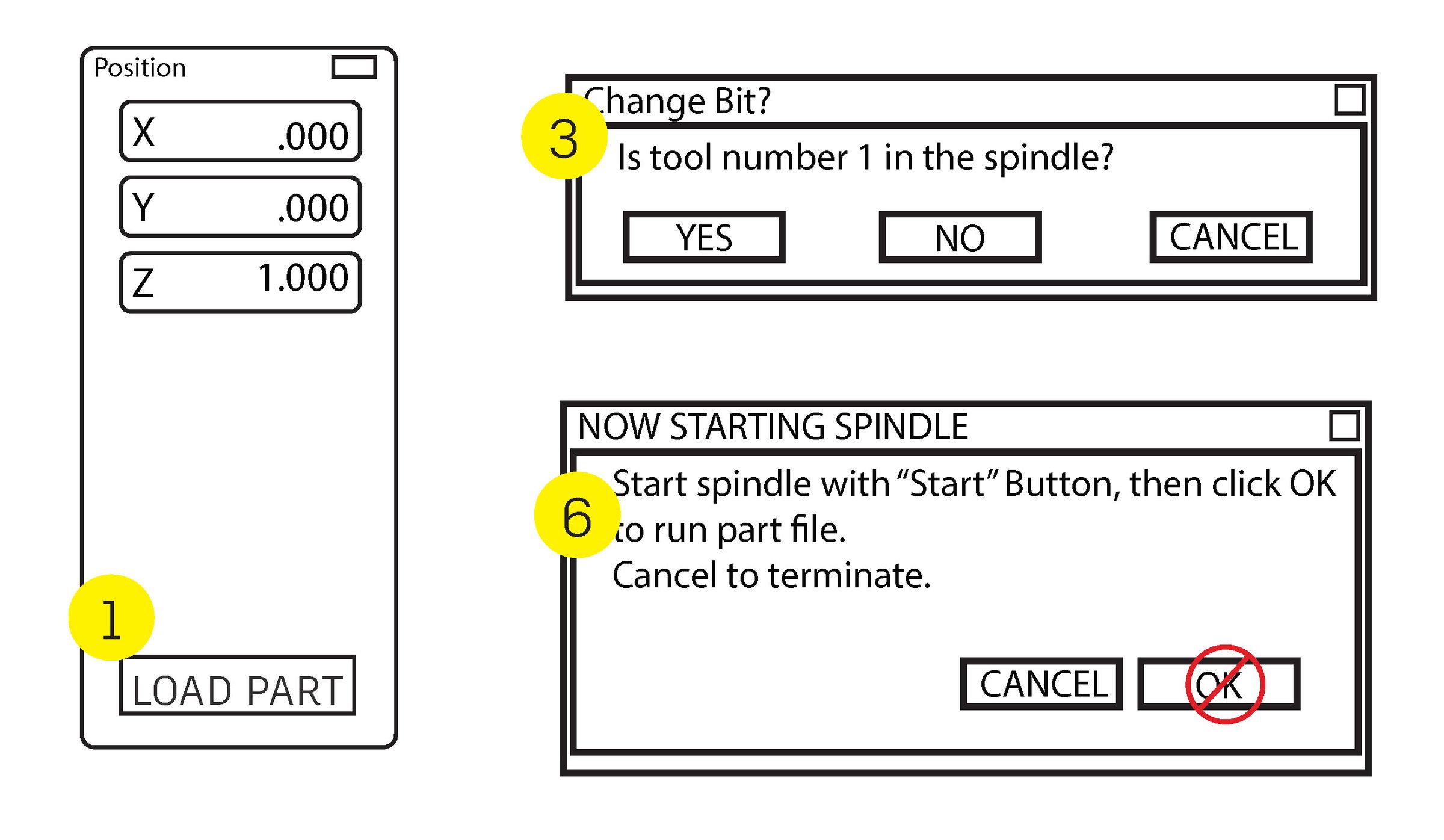

Step 2: Load the Part File
- Click Load Part in the Position Dialog.
- Load your .sbp file.
- Confirm that the tool in the spindle is tool specified in your CAM.
- Click OK in the Position dialog
- Do not click OK yet
Step 3: Prepare for the Air Pass
- Check that the zero plate has been put away.
- Check that the ShopBot table is clear.
- Click Start in the Position Dialog.
- Do not click OK yet.

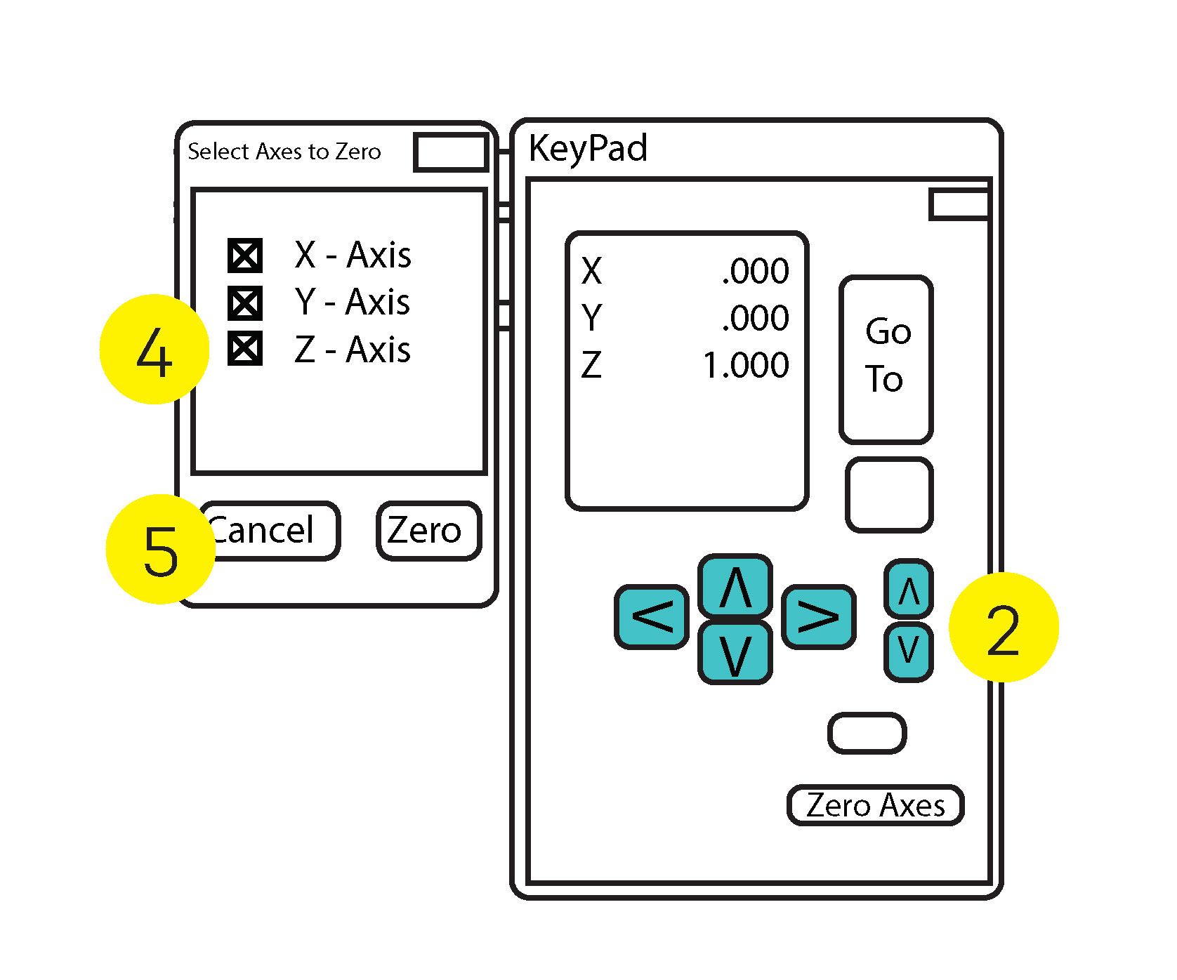

Reset Z zero
- Open the KeyPad dialog.
- Jog the spindle down to the real Z zero.
- If you went to 2" to set Z zero for your air pass, go to -2".
- Click the Zero Axes button.
- Select Z - Axis.
- Click Zero.
