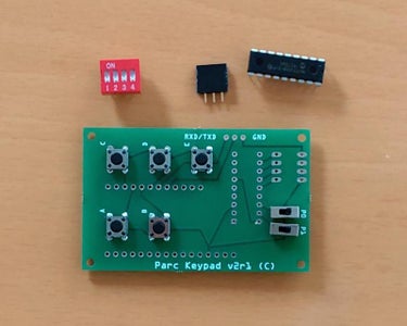

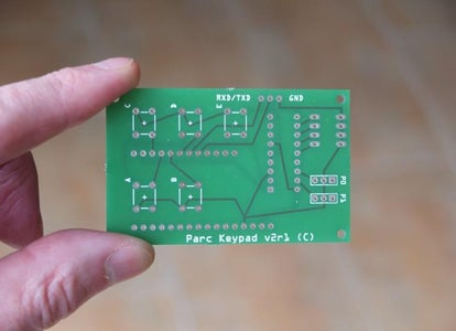

Step 2: Printed Circuit Board
I had mine produced by Aisler (https://aisler.net/). At Aisler, it is possible to produce the PCB directly from the attached Fritzing project file.
If the manufacturer of your choice does not support Fritzing as import format, then try the Gerber files. "All" manufacturer support Gerbers.
Step 3: Soldering Keypad
Solder the five push buttons and the two slide switches to the front side of the PCB. Turn the PCB and add the MCP23008. Make sure the direction of the IC is correct.
Add the DIP switch.
From a female header stack, break out a piece of three pin sockets. Solder this piece to the back side of the PCB.

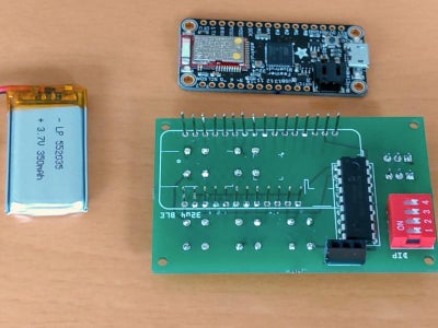

Step 4: Soldering Micro Controller
Solder the header pins to the back side of the keypad. You can also solder the pins first to the micro controller board and as the second solder it to the keypad.
Solder the pins flush to the keypad. The plastic distance holder that holds the pins as an array is by default set that the pins look out 1 mm. So you have to push the pins 1 mm down first.

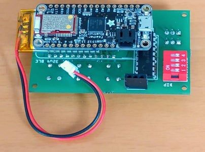

After the pins are soldered to the keypad, remove the black distance holder band. The battery will required all the space in between the two components.
Lastly, add the micro controller board. The battery shall be free movable between the two components.

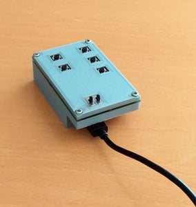

Step 5: Assemble
Connect the battery to the micro controller board. Now you can put whole assembly into the case and use it.
That was it basically. Next you will learn how to install the software and program the remote control.

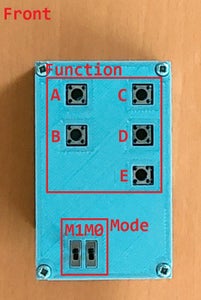

Login Commands:
{ 1 A: BK <Ctrl> <Alt> <Del>; W 2000; BT password; W 1000; BK <Enter>; }
  • "1 A" defines the key and mode the program is for. "1" is mode 1 which is set with the slide switch M0. "A" is the upper left button
  • "BK <Ctrl> <Alt> <Del>" sends a "Del" keypress with the control keys "Ctrl" and "Alt"
  • "W 2000" lets the program wait for 2 seconds. The program waits for the Windows login screen before it writes the password
  • "BT password" sends keypresses "p", "a", "s", ... . Note that it assumes a US-English keyboard. If you have keyboard settings for a different keyboard, there is a simple trick: Send "BK " as the first program step. This will change the keyboard on the PC.
