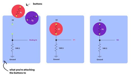

Lets say you want to make each button to trigger a song to play, then the Arduino needs some way to know what button was attached and then pressed. Rather than using RFID I "hacked" a solution that uses different resistors in a resistive voltage divider.
A resistive voltage divider allows you to make a correspondence between a resistor and the value coming into an analog input port on an Arduino. If you make R1 much bigger than 10K Ohms then you'll get a very low value into the analog part. If you make R1 much smaller than 10K Ohms you'll get a high value into the analog port.
This means we can use a bunch of resistors that all have different values and associate each one with a button. When a button in connected into a voltage divider, the reading from the analog in port will allow us to determine which button what pushed.
So how do we convert this handy circuit into buttons?....read on...
Step 2: Using Band Buttons in Voltage Dividing Circuits
To use each button as a unique identifier, I embed part of the circuit in the button and the other part of the circuit in whatever you're attaching the buttons to (I used a sweatshirt). This allows you to make the buttons interchangeable!
But, if we implemented the buttons like the schematic shown here, then anytime the button is attached, the circuit sends a voltage value to the analog port. If you want the act of connecting the buttons into the circuit to trigger some action than this works great! If you want to have lots of band buttons on your sweatshirt and then you want to push the band button that you want to play at a given point then you need to make your band button into the kind of button you can press to trigger a signal....

If you want an LED to light up when you push the button, then you can attach an LED with one end going to ground and the other to a digital output pin on your Arduino or other microcontroller.
Pick one of the snaps and grab the wire that is attached to it. Solder a 10K ohm resistor to the end of that wire. The end of the resistor that is not attached will then go to ground. If you have multiple wires going to ground, you can use whatever means you would like to combine then into a single wire, I soldered two wires together - whatever works, right? Take the wire that connects the snap to the resistor and solder a branching wire off from a spot between the snap and the resistor. This is your voltage divider so it's really important that the electricity flowing from the snap hits the branching wire that will eventually go to analog in before it goes through the resistor to ground.
Step 6: Connect to Arduino and Play Around With Possibilities
Use the diagram above to connect the four wires coming our of your circuit to the Arduino.
