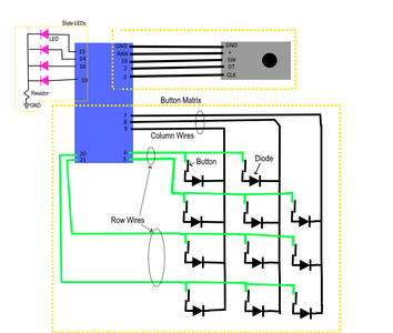

Step 1: Case
As with any project I like to get the case started first. Especially when printing one, as it takes a while and I only need to slice and load the file and the printer does the rest. Here is a link to the case that I designed for this project: https://www.thingiverse.com/thing:4792978
This project does necessitate the at least the top of the case being done before moving on as all of the parts need to be clipped into the top and then soldered together.
You don't need to print a case for this. You can use what ever you have access too.
For this case design I would recommend checking the dimensions on your keys, LEDs, and encoder before printing the whole thing.
Step 2: Assemble the Top
The begins by installing all the switches into the plate. The best fit on the switches is a bit tight, that way you can remove any key caps and the switch won't pull out.
After adding the switches bend the ground leg of the LED down at a right angle and place them into their spots at the bottom of the plate with the bend leg on the outside.
If your encoder came with header pins, like mine did, you will need to remove them before you can put the encoder in place as the pins run into the switches. To do that use your snips to clip the plastic that holds them all together and then remove them one at a time using a soldering iron to heat the pin and solder and a pair of pliers to pull the pin out. Once the pins have been removed you can put the encoder in place and attach it. It may also be easier to wait until you have soldered the wires onto the encoder before putting it in place.
Step 3: Soldering
Soldering this is the hardest part.
Each of the switches needs a diode and a wire. We are basically making a grid wires with a switch and diode at each intersection. The diodes help in case more than one switch is pressed at a time. I've attached a circuit layout that I used (or pretty close). The pins aren't hugely important, as they can easily be swapped in the code later. Make sure that you avoid pin 0 and 1 (RX and TX) as I think they are used to communicate with the computer; tying into them might be weird.
There are 3 pins that are important. They are the pins from the encoder. The encoder will work best if the moment tracking pins connected to interrupt capable pins on the Micro. On the Pro Micro attached to pin 2 and 3. They are important as they track the movement of the encoder. If you have the same encoder I do they are the DT and CLK pins. The encoder I have also needs +5v to work, so the power needs to run from the RAW pin. The RAW pin exposes the +5v coming from the USB port. All other pins will run at 3.3v.
Step 4: Code
Now the fun part. For this version I am breaking the code down into a lot more functions. Functions are useful as the make it a lot easier to keep each section of your code small. By making each section smaller, its easier to follow.
The main thing to remember with functions is that each function should only do 1 thing. The other thing to remember is why write code many times when you can wrap it in a function and use it a bunch of times.
I've attached the code below and if you are interested I have an in depth walk through in the next step.
For the actual key functions I've left a few in Layout2() for you to look at. With this code always remember when sending key strokes make sure that you release any keys you press. Some of the functions like .send() do release the keys they press but .press() does not. Use .releaseAll() to release pressed keys.
You can change the pin numbers at the top to what you have used.
