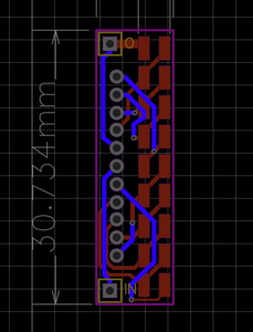

I wanted to make this project as small as possible which is why I decided to use SMD components and create my own PCBs. 1210 is about the smallest package that I can solder by hand. There are many great guides on how to create a custom PBC. Also feel free to check my other instructables for details on the process.
This circuit is fairly simple but I needed to make sure the decade counter output pins line up with the pins on my PCB. I also need to ensure the size of the pads for each resistor was for the corresponding surface mount package. I will need a separate PCB for each decade counter which is a total of 7. The Gerber files are listed below.

Once the PCBs arrived, the next step was to solder all of the resistors. This was a tedious process but I was able to successfully add all of the resistors.
Once the resistors were in place, I soldered pins to each board and utilized some blue tack to stabilize the board and keep the pins straight.
The next step was to connect the PCBs to the counters via the pins. The copper pads on the counters were difficult to solder to and the joints were not very consistent but I confirmed each connection with a multimeter.
Once all of the individual counters were complete, the next step was to add jumper wires between each counter. Finally, 2 additional wires were connected to the terminal block to incorporate all of the counters into the circuit.
