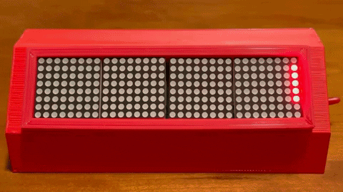

Introduction: Programmable Sticky Note: Desktop Scrolling LED Display
About: I like tinkering and experimenting, mostly with microcontrollers and 3D printing.
Have you ever been at work and suddenly remembered something you really need to do at home (or vice versa), but you're worried that you won't remember to do it when you finally get there? You might phone or text to ask someone to put a sticky note up as a reminder, but that won't work if no one is there. This Instructable offers an alternative approach that allows you to upload text to a cloud service that will send your text to an inexpensive (< $20 in parts) Desktop Scrolling LED Display that is much more likely to grab your attention than a paper sticky note. Of course, an electronic sticky-note is is just one of several ways to use this device. For example, it can be also used as a clock/calendar, a desk nameplate, a customer counter display, a message receiver, and much more).
The scrolling display uses a small (32 x 132 mm) 8 x 32 LED matrix module connected to an ESP8266 development board. The LED matrix and ESP board are powered by a rechargeable 3.7 V Li-ion battery (18650) attached to a battery charging module (TP4056). Everything is contained in a 3-D printed enclosure that makes it completely portable within range of your Wi-Fi signal.
The ESP8266 code takes advantage of the Adafruit IO (AIO) cloud service, which is available free for the small number of data feeds (<10) used here. Users with AIO accounts can upload 3 different text messages to the cloud via phone, tablet or computer. Users can also select which text message is displayed, the time of day it will be displayed, and the rate at which the message scrolls across the LED matrix. If no message is selected, the default display will scroll the time of day, day of the week and date.

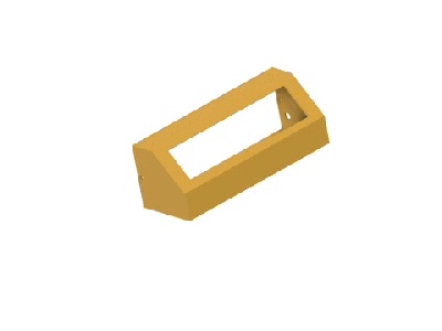

Step 2: Print 3D Parts
The printed parts are shown in the pictures.
  1. Enclosure (PLA): The enclosure was printed with supports at a 0.38 mm layer height (20% infill). To minimize the amount of filament used for supports, the enclosure was printed with the back (open) side of the enclosure facing up.
  2. Back Panel (PLA): The panel was printed at a 0.38 mm layer height (20% infill), without supports
  3. Matrix Holders (TPU or NinjaFlex): The LED matrix is attached to the main enclosure using rectangular rings printed with a flexible filament (0.25 mm layer height, 100% infill, no supports). Print 2 of these.
  4. Battery Holder (PLA): The 18650 battery holder was printed (0.38 mm layer height, 20% infill, no supports) using an STL file downloaded from Thingiverse (thing:2289291). This file is not included below so you will need to click the Thingiverse link to download the file appropriate for your battery (long vs. short version). The short version provides a nice snug fit for the EBL battery linked in the Supplies list.
Items 1, 2 and 3 were designed using Fusion 360. The f3d file and the three STL files can be downloaded from the links below.

After several seconds, the following message should scroll across the LED matrix: “Connected to Adafruit IO.” This will be followed by the default scroll (time, day, date). The default ONTIME is set to one minute after midnight (0001) and the default OFFTIME is set to 11:59 pm (2359). The default scroll SPEED is set at "25" and the default duration of the pause at the end of each scroll is 1 sec. The default pause duration can be changed by editing line 28in the sketch and saving/uploading it again. The values of ONTIME, OFFTIME, and SPEED can be changed at any time by adding new values to their Adafruit IO data Feeds (see Step 9).
