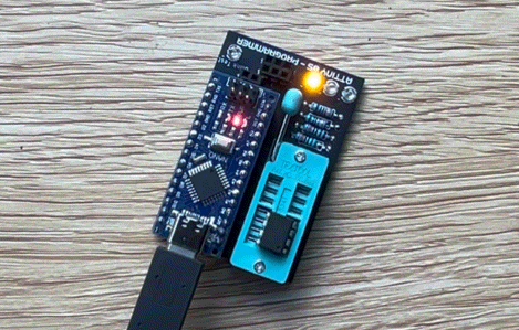

Make your own ATtiny 85 programmer using an Arduino Nano and a custom made PCB!
I've been building a few projects of late that use a ATtiny 85 microcontrollers and wanted to create a specifically designed programmer to make the job easier.
If you are an old hand with programming ATtiny 85's or a total novice and want to learn, then this bit of kit is essential. Once you have the hardware, programming the ATtiny becomes quite simple. I did do an 'Ible on how to Program a ATtiny with an Arduino which you can find here. Note that I was only really just learing then myself and did the Ible so I wouldn't forget how to do it! However, the programmer I did make was rudimental and I wanted something more permanent.
Along with the build of this project, I'll run through how to program the ATtiny 85 and get the blinking light sketch to work. Once you have conquered that - the sky's the limit!

Step 2: Adding Components to the PCB Part 1
This is pretty straight forward as there really aren't many components to add to the PCB!
STEPS:
  1. Always stsrt with the lowest profile components which in this case is the resistors
  2. Solder the 4 LED's into place. 3 of these are indicators when the sketch is uploading, the other is for the blink skech whih we will load upa little laer to the ATtiny. It's a simple way to make sure everything is working as it should be.
  3. Next you can add the header pins in for the capacitot. The capcitor is removable as you can sometimes have issues with loading Sketches when it is in place.
  4. I've also included a header pin so you can use jumper wires to connect to an ATtiny if it is soldered in place to a PCB. This can also be soldered into place.
  5. Now you can add the Arduino to he PCB. Make sure that you add the header pins in first to the Arduino and then solder it intp place to the PCB. It will ensure that the Arduino is lined up right and the header pins go in straight
Step 3: Adding Components to the PCB Part 2
Now it's time to add he ZIF socket IC holder. This is an easy way o hold he ATtiny into place whist you are programming it
STEPS:
  1. Place the socket holder ino place in he PCB
  2. Make sure that the little lock handle is facing down towards the LED's
  3. Now you can solder it into place
  4. Trim the capacitor legs and place into the 2 header pin. I have indicaed on the board wih a little - symbol which leg of the cap needs to go to ground.
  5. Lastly, add a ATtiny to the ZIP socket holder
That's it - you are now ready to sart programming your ATtiny

  1. Once you are ready to upload the blink sketch to the ATtiny (just follow the steps in the vid or the link above), open the 'blink sketch' in my Google Drive
  2. Upload the sketch to your ATtiny 85
  3. Watch the little LED blink away!
