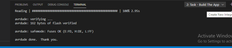

      Step 3: Configure Task File
      • Press F1
      • press tasks: configure tasks(choose any task)
      • modify as shown in the image rename the label as you like, here we have chosen Build and burn App
      • Notice that make program must be installed for the command to work and specify the path
      Now you can press Terminal from the task bar then Run Task and run the task that you have configured.
