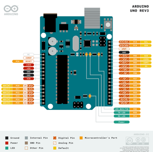

Step 1: Hardware Setup
  • check the datasheet of arduino
  • check the connection of OLED
  • connect scl and sda and use 2 pull up resistors and gnd and vin
  • connect the my smart usb to the icsp = in circuit serial programming - pin
  • the nose is directed inside the arduino
  • connect the arduino board with USB
