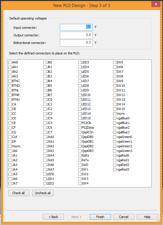

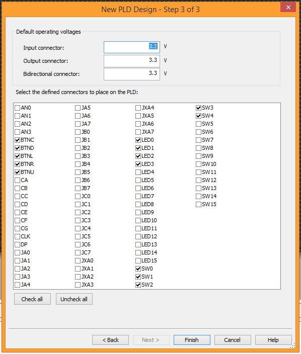

In the next window you can select all of the external I/O peripherals attached to the board that you want to add to the project. For this project, I'll need 5 LEDs and 3 switches, so I chose LED0 → LED4 and SW0 → SW2. Click "Finish" after you've made you selections.
The PLD project will now appear in the Design Toolbox on the left side of the Multisim window and the canvas will now display the selected I/O connectors.

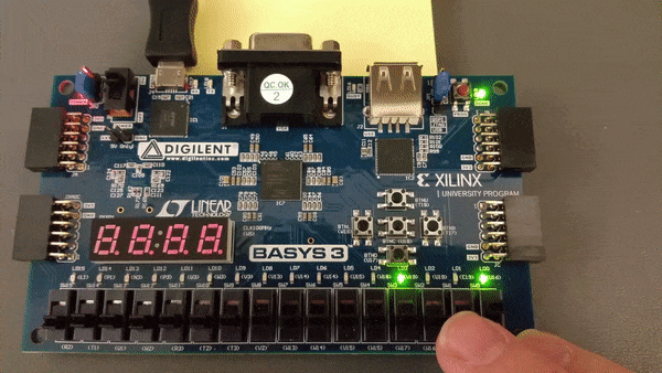

The next step is to send the code to the FPGA. Make sure that your FPGA board is connected via USB and that it is turned on. Then click on "Transfer" in the menu bar and select "Export to PLD..."
In the next window you can select one of several options. Click the radio button to select "Program the connected PLD".
In the next window be sure that the "NI LabVIEW FPGA" tool option is highlighted in the box. Click "Finish" at the bottom to program the FPGA. I also tried using the "Xilinx Vivado 2016.4" option and it worked fine.
Multisim will then connect to Vivado to generate the correct files it needs to program the board. This may take several minutes. Once the 4 steps are complete, your board is programmed and ready.
Here is my Basys 3 with the Full Adder circuit loaded.

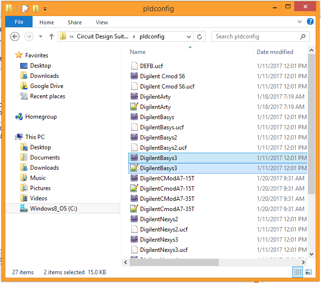

Multisim uses configuration files to communicate between Multisim and Vivado. Each board requires two, one with extension *.mspc file and the other with either *.ucf or as *.xdc. If you have either the Basys 3 or the Nexys 4 DDR (not the original Nexys 4) these files are either missing or incomplete, so here is a quick walkthrough on how to add and/or modify them. If you are using any other board, you can skip this step.
For the Nexys 4 DDR the files are not included by default, so first be sure that Multisim is not running. Then download the DigilentNexys4DDR.mspc and DigilentNexys4DDR.xdc files at the bottom of this step. Next, navigate to the Multisim directory where the configuration files are stored. The path name should be something similar to "C:\Program Files (x86)\National Instruments\Circuit Design Suite 14.1\pldconfig". Once there, move the two downloaded files into this folder. Open Multisim and program a project to your Nexys 4 DDR as outlined in the previous steps.
The Basys 3 configuration files that are packaged with Multisim when you install it are missing some definitions. If you simply want to download the correct versions and overwrite the existing files, download the DigilentBasys3.xdc and DigilentBasys3.mspc files at the bottom of this step. Navigate to the Multisim directory as noted above and overwrite the existing two Basys 3 files. If you want to go through the process of modifying the files, continue reading.
When you open a new PLD project in Multisim and select the Basys 3 as your target board, there are several I/O options that are missing. Specifically, the definitions for the VGA, RS-232, USB HID(PS/2), and quad SPI flash are all missing.
In order to fix this, we need to modify these installed configuration files. To find them, first make sure that Multisim is not running, then navigate to the root directory for Multisim. The file path should be similar to "C:\Program Files (x86)\National Instruments\Circuit Design Suite 14.1\pldconfig". Find the two files labeled "DigilentBasys3". One file has a .xdc extension, the other has a .mspc extension.
Before going any further, be sure to make a copy of these two files and place the copies in a separate directory and folder, like a new folder on your desktop. In the event something doesn't work, you can copy the original versions and try again. I also don't recommend you modify the files unless you are confident in your abilities. Erroneous changes won't affect Mutisim's performance, but your board won't program properly.
In order to make the changes, you need to use a text editor like Notepad++. Don't double click the .mspc file to open it. It will open Multisim, which is of no use to you at this point. You need to edit the actual text in the file that Multisim reads to load the correct board configuration, so right click on it and select "Open with..." Select your text editor from the options available. .mspc files are written in a mark-up language format, similar to HTML or XML. It's a simple format but it needs to be correct.
