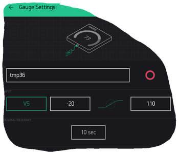

Then I try to show how you can read DHT11 and TMP36 data and display it on the BLYNK page.
I also used the Gauge, Values and Graph widget. They are really nice.
I also automatically toggle an LEDWidget on the Blynk Page to turn on and off every 2 second.
There is also an LCD that you can display pretty much anything but I just write some simple if and then function to display preset text based on the temperature.

How about TMP36, well this is a bit tricky but if you search the internet, you will find lots of people already try this. The important part is the ADC (Analog to Digital input) is referred to as Pin 17. It is always 17 if you are using ESP8266. This is coded in one of the library file for ESP8266. I don't remember which one.
And the other thing to remember is the reference voltage is around 1.10 Volt. And there is a maximum voltage limit to this ADC pin. So don't just let 3.3V go all the way in. Use a voltage divider and adjust your conversation table or formula in your code accordingly with this voltage divider. In my sketch example, I use equal value of R1 and R2 so the math is simple (a factor of 2).
