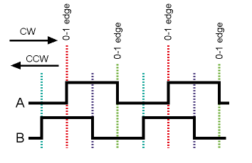

As you can see, there is a cycle of 5 steps for an entire movement, those steps are:
CLK(A) and DT(B) bit pairs for CCW (Moving Left):
- 11
- 01
- 00
- 10
- 11
CLK(A) and DT(B) bit pairs for CW (Moving Right):
- 11
- 10
- 00
- 01
- 11
This means we can reduce the entire cycle into a single byte (char) like so:
- 01001011 for CCW
- 10000111 for CW
You may visualize these A/B cycles in the picture above.

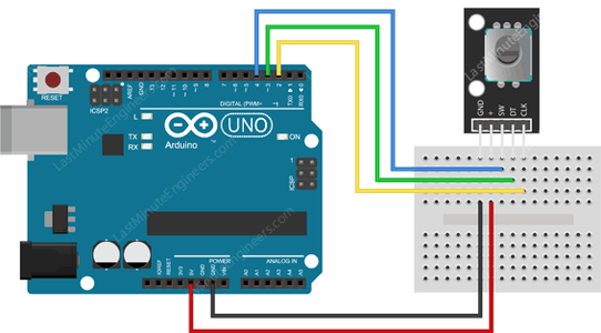

Step 1:

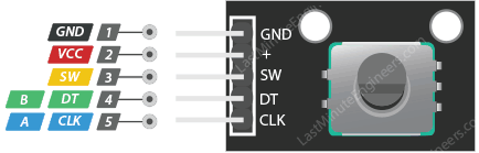

Wire the Rotary Encoder accordingly to the picture, like this:
- CLK to Arduino pin 2
- DT to Arduino pin 3
- SW to Arduino pin 4

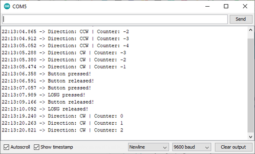

Step 2: Robust and Simple Programming
For the Robust and Simple programming code use this one:

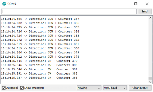

Step 3: Robust and Fast Speeds Programming
For extremely high speeds you have to use bit operators and port registers. In this case use the following code for the Rotary Encoder:
