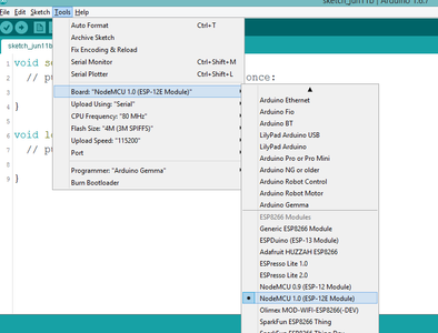

Step 3: SELECT YOUR BOARD
step 1)Two types of board are mainly available, one with version 0.9 and other with version 1.0
But version 1.0 is recommended by me, as i had some issues with v0.9 like,
a) Automatic resetting
b) Not breadboard friendly
the only advantage, of version 0.9 is that its cheaper than the v1.0
step 2) goto to "PORT" - choose COM port, which is greater than 2, normally you will find "COM 7"
NOTE:- Keep rest of the parameters, default, as shown in the picture above
