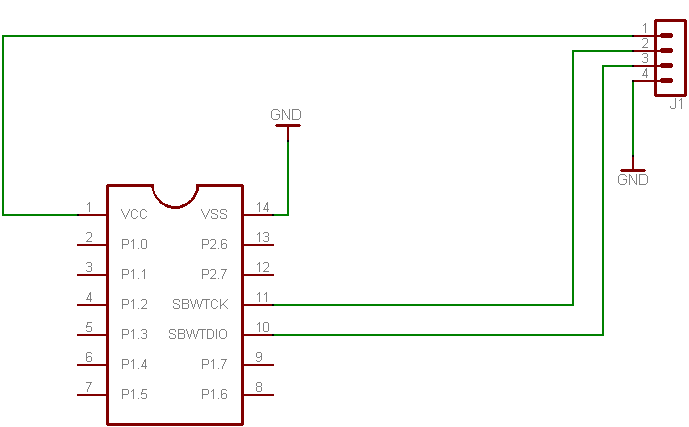

I've built two programming boards. The first uses a small breadboard, ZIF socket, and 4 wires from an old IDE cable with the 4 pin socket soldered to one end. The Zero Insertion Force socket just saves on effort when moving the MCU around.
The second uses a DIP socket from Mill-Max and some pins I had laying around, as well as some other components. I've wire wrapped most of the connections. It was only necessary to solder the 4 pin socket. Basically it's a proto-board without the oscillator. See here for the proto board schematic.
Table 2-2 of TI document slau144c (the MSP430x2xx Users Guide) shows the unused pin terminations. This is important for your project board, but not the programming. The MCU won't run your program unless you pull the RST pin high using the 47k resistor.
Another note on pin sockets. When you connect the ez430 pins to your 4 pin socket be sure that the Vcc connection is correct. You can verify this by looking at the schematic in the ez430 Users Manual. Notice that R10 is attached to Vcc on the ez430 side. You should be able to follow the lead on the board back to the nearest connector pin which is pin 1 of the connector.
As an aside, you could build the 4 wire programming connection, called Spy-Bi-Wire, into your final application, and you wouldn't have to remove the chip at all. If you decide to do it that way, then you can power the MCU from your application's 3V power source and just connect pins 2 and 3 (see J1) on the USB programmer to your MCU.
