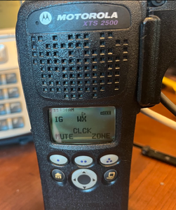

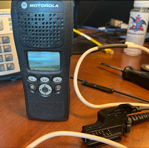

Motorola XTS 2500 walkie talkie
Laptop/ computer with Motorola ASTRO 25 portable CPS software version R20.01.00
Programing Cable RKN4105A (Should be included with radio upon purchase)

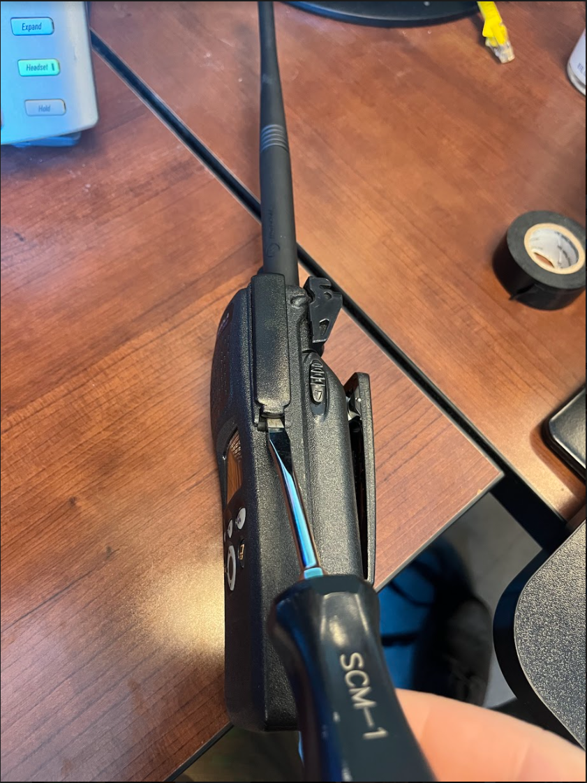

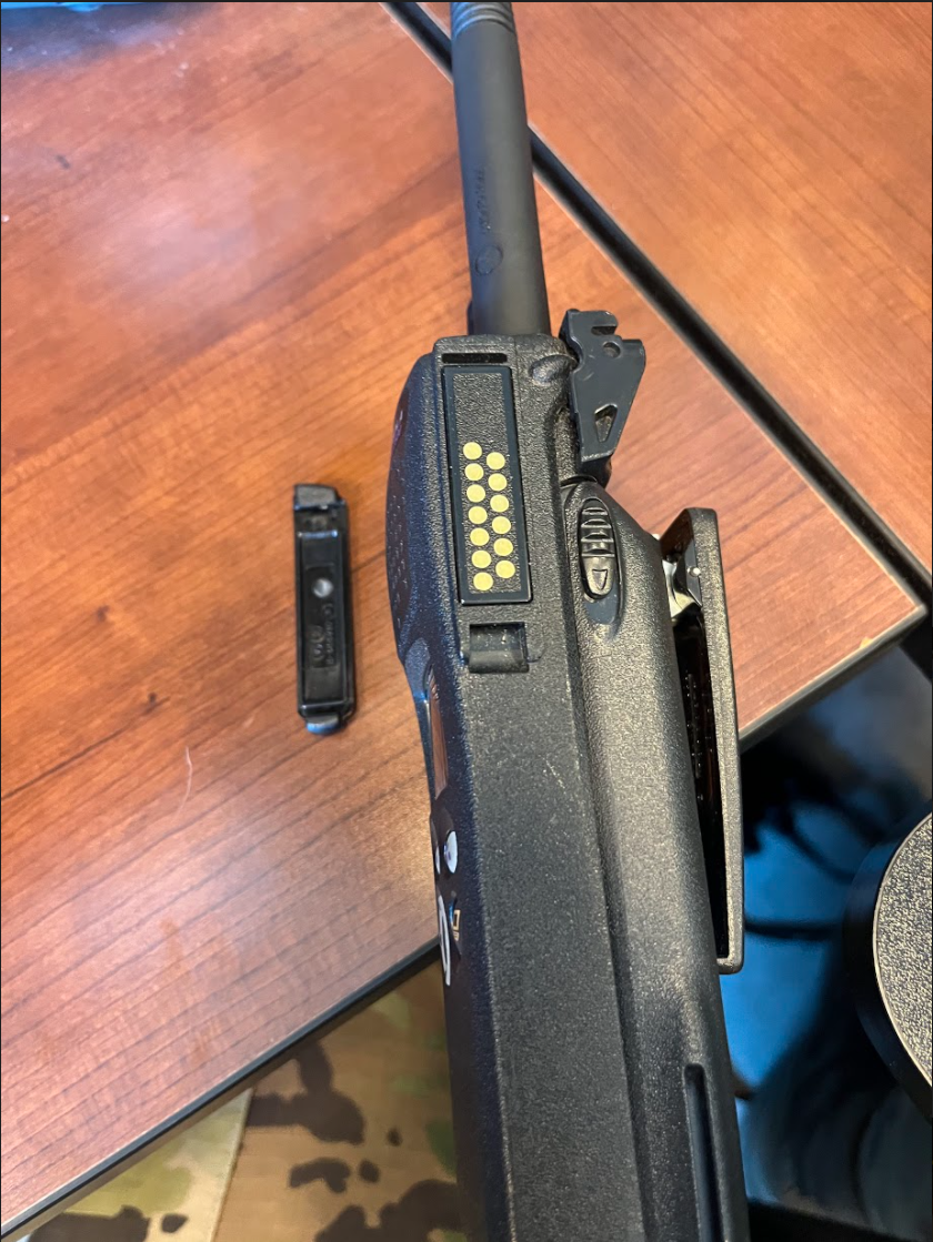

Step 1: Dust Cover Removal
To remove the dust cover off the radio, use a pry tool to remove it. Pry from the bottom and it should pop off very easily. Make sure to reapply the dust cover after programming. They are literally indestructible so don’t worry about breaking them.
Step 2: Plugging in Radio to the Computer
Plug the usb cable into the usb port on the laptop. Then, attach the other end to the radio. The easiest way is to hook the connector on the top of the radio and then rock the bottom into place. It should snap on. Once complete power on the radio

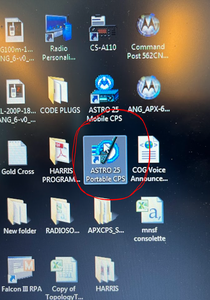

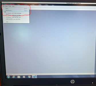

Step 3: Open Astro 25 Portable CPS Software
Icon should look like what is circled in the pictured above.
Step 4: Getting to the Code Plug
Open the program “ASTRO 25 Portable CPS”

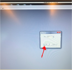

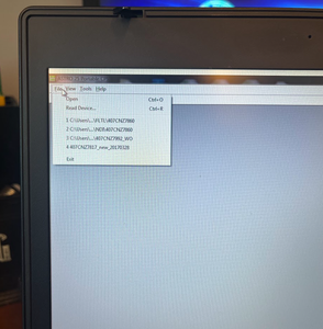

Then click "File"
Then select "Read Device"
Then elect “USB” from the drop down
Finally select "OK"
The code plug should pop up.

• Squeeze the connector against the radio with a firm grip
• Clean the contacts on the radio with a pencil eraser. *DO NOT USE WATER OR ANY SOLUTION ON THE CONTACTS, YOU WILL FRY THE RADIO*

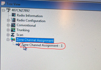

Step 5: Inside the Code Plug
Once the Code Plug is open, click the plus sign next to “Zone Channel Assignment”.
Step 6: Inside Zone Chanel Assignment
Then, double click “Zone Channel Assignment - 1”.

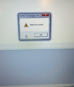

Step 8: Writing the Code Plug
Select “File” in the top left.
Then, select “Write Device”
Then, select “USB”
Then, select “OK”.
*You should hear some beeps and weird noises.*
Then, a pop up should say “Write Successful”
Then, Select “OK”
You can disconnect the radio and connect the next radio.
