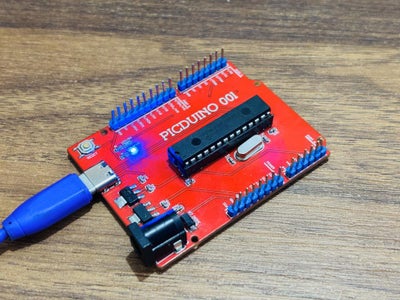

In the previous tutorial I have designed a PICDUINO board, all the hardware files are shared in that previous article. Today is the day to program this board through the USB port. I have used a PIC18F2550 which is an 8 bit microcontroller similar to an Arduino. It directly supports USB protocol without any interlink chip in between. Which is a great feature of it. Today we will use this feature and program the chip with a blink code. Choosing a blink sketch makes the process easy to learn.

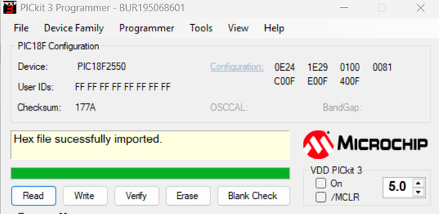

Download the USB bootloader hex file from here, Connect the PICDUINO with PICKIT 3 using the wired diagram given here. Write the hex file in the program memory of PIC18F2550. To know the full process of writing a hex file to IC, see our getting started with PIC tutorial from here. After successfully writing the bootloader file in the chip now, we can program the chip using USB only. There is no need for PICKIT anymore. Let’s make a hex file of blink code and program it via USB.

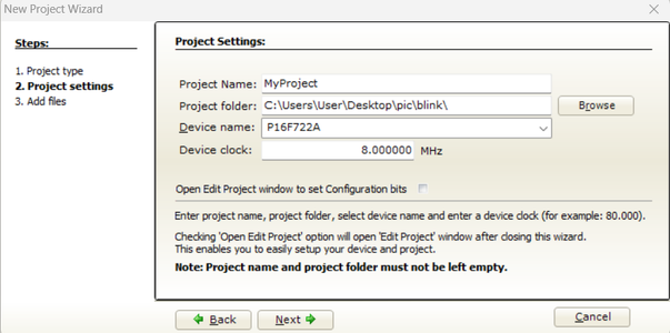

For the compiling of the code, and to convert the same into HEX. I am using MikroC Pro software. This one supports the whole family of PIC and is very easy to learn in the first go, if you are a beginner. Let’s convert the code into HEX in 4 steps.
  1. Download the software, make a new folder and set up a project in that as a standard project.
  2. Change the CPU clock as per the max clock the IC can work on, see in datasheet.
  3. Go to the edit project section, under the project tools menu. Under the general output setting tick export as hex.
  4. Build the file, It will make some at the project location in the same folder. We only need the Hex file to copy it from there to a safe location. And that is all what we need from the compiler.

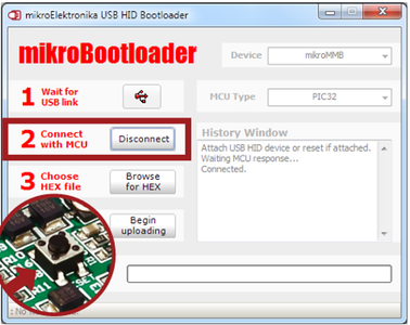

Step 1. Establish USB link: Connect your board to your PC. When the device is recognized by your OS the gray USB icon will turn red, indicating that the USB link is successfully established. You have 5s to proceed to the next step. If you wait too long the device will disconnect.
Step 2. Connect with MCU: Click on the Connect button within 5s. The chip automatically enters the Bootloader mode and is ready for further instructions. If your USB link disconnects, just reset the chip to reestablish the link. Then proceed with step 2 again.

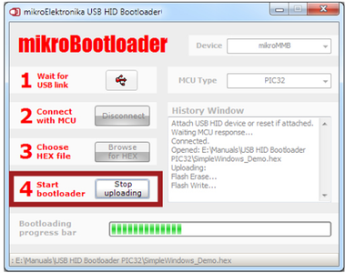

Step 3. Choose HEX file: Time to choose blink.hex file, Load the program you want to upload into the chip by clicking on the Browse for HEX button or simply drag and drop your HEX on to mikroBootloader window. You’ll be notified in the History Window that the file is opened.
Step 4. Start Bootloader: Start bootloader by clicking on the Begin uploading button. You can monitor the bootloading process in the progress bar. After the process is completed, a new message window will inform you of the bootloading success.
Step 5. Reset chip: Bootloader firmware will automatically reset the MCU, after which you should wait 5s for your newly loaded program to start.

I follow all the steps. It will automatically detect the chip. And after uploading it will show “successfully uploaded”. In this way you can program your PICDUINO now. Which is a way easier method to program a microcontroller. Usually factor made chips do not come with pre-programmed USB bootloaders, hence there is always a need for PICKIT. Yet there are some cheaper options and clone boards available in the market. PICKIT 2 is open sourced, and the next tutorial is based on the same. So that we can make our own PICKIT 2 and program any chip in future.
