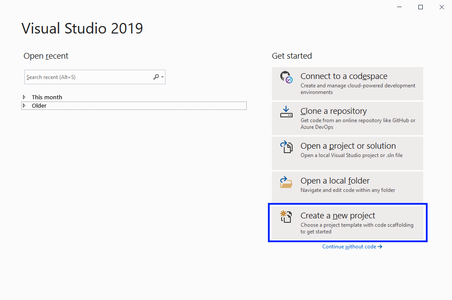

Then, if everything went well and Visual Studio 2019 hasn't already opened itself, you can open it at any time by first pushing either the Windows key on Windows or cmd + space on Mac, then typing in "Visual Studio" and selecting Visual Studio 2019. If Visual Studio opens correctly, you will be greeted with a rather minimalistic start menu that looks like the image to the left at the start of the next step.

We're almost ready to start. Now that you have Visual Studio open and ready, simply select the button on the right that says "Create a new project", as highlighted in the image to the left above.

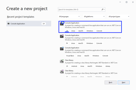

Once it's ready, click to select "Console Application" and make sure that "C#" is listed directly below it as well as in the thumbnail next to it, like the image to the right above. There are multiple different types of console applications built into Visual Studio for different programming languages, so make sure you pick the right one.
Now just push next, give it any name, choose your own location to keep it if you would like, and hit next again to create the project. If it asks, set the target framework to ".NET 5.0". Note that pushing enter at any point in this screen will skip to creating the project, so be careful when entering a name.

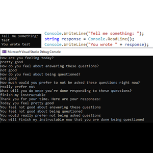

If you put the line in, then your script should look something like the image above. Go ahead and test the program, it'll let you write text, but as soon as you hit enter, it ends.
Step 6: Repeating the User's Response
At last, the final piece to our program: using what the user inputs. We'll do this with a line of code that resembles a combination of the last two steps:
Console.WriteLine("You wrote " + response);
If you've been following along to this point, what you see here should make some semblance of sense. For one, it starts with Console.WriteLine, which is the same thing that our first command does. Just like before, that tells the program to type some kind of text. The difference now is that in addition to just a pair of parenthesis, we have our name from the last step.
The parenthesis were explained in step 4, so I won't spend any more time on them. Immediately following the parenthesis however is a plus symbol. This tells the program that we have another thing that we would like to add to the text. That other thing we would like to add is the text we collected previously in the last step, so we put the name we assigned it to after the plus symbol. Note that we do not put the name in parenthesis. This is because we want the program to write what the name represents rather than the name itself.
If you did everything correct, then you should have all the basics done! You can check the images above for what the script should look like, though feel free to customize the text it writes. Just save it then test it! Always remember to save.

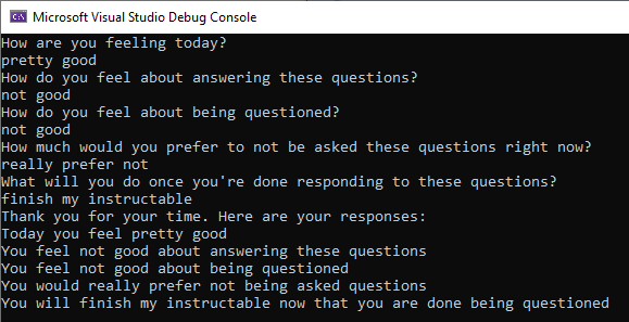

Finally, you're ready to go off on your own. You've learned everything that you'll need, so now it's time to make something yourself. I like to copy and paste commands around when I'm first learning what to do, then I change up the text later. Remember how each line we've done so far works, and use that knowledge to make something new.
Above is an example of something I made. I won't be providing the code. I challenge you to recreate it yourself as a final test to prove your understanding of this instructable. It might be hard, but make sure everything lines up correctly, as human error when writing code is almost inevitable. If you do it, then you can say so below, but please don't post the code so that others can be challenged too.
